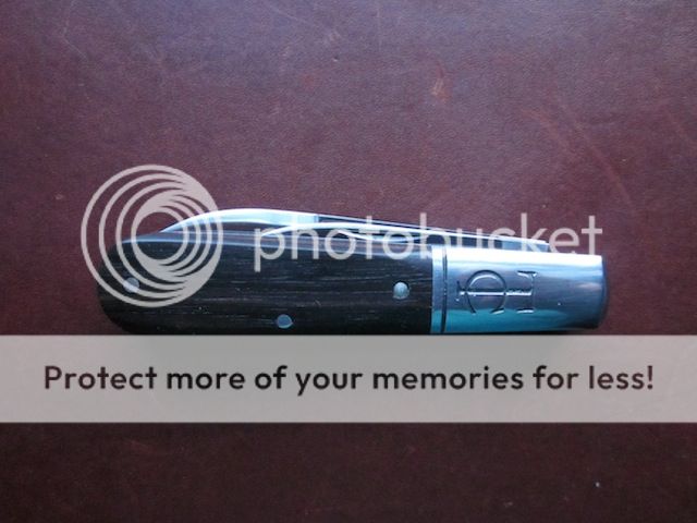

Did you happen to send them a picture in your email so they could actually see your knife and how bad it is?
No, unfortunately I did not. Hindsight - probably should have.

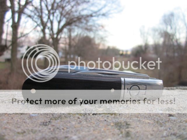

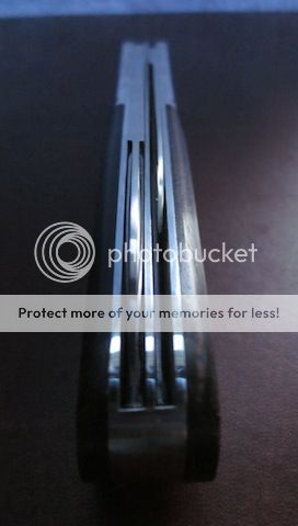

As for "it was manufactured that way," barring a defect-- such as with Jack's knife, which shouldn't have made it out the door, and possibly with yours as well-- it was.
Meaning, the spear main Boys Knives shared tooling with the first run of TC barlows which featured the low, mostly-hidden long pulls on the spear mains, with the front-sitting pen blades both swedged at their backside and with some give to allow better access to that long pull. The design decision(s) clearly favored a more streamlined closed-blade profile (and the deliberate use of a long pull vs. nick) as opposed to better access of the main blade.
Right away (with that first barlow, and before the Boys Knife), I encountered a "learning curve" in accessing the main blade, a different and non-intuitive approach (more straight down than from the side). I quickly got used to it, but it's definitely a challenge. I realized that all over again recently when, after not carrying either knife for a time, I struggled to open the main blade on the Boys Knife and had to re-learn that idiosyncratic approach....
Given how difficult it can be to readily access a "perfect" spear main with this design, I can well imagine how much worse it would be if the main is lower or the pen higher, even before arriving at the extreme displayed in Jack's.
So: yes, this is "how they are made." Or rather, how they were made. As noted, the second run (of the barlows, at least-- are there any pen-behind Boys Knives?) placed the pen blade behind the spear main, which I take as evidence of an understanding that it was a non-optimal design decision from the get-go, prone to worse problems with manufacturing variations, and that a course correction was warranted.

At least the pulls on the main blade on these is visible. Not so on the knife in question here.

Here is a spear with pen in front that works, it IS possible to build one with good access to the long pull, GEC just did not.
