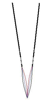

It appears that GEC uses wheels to sharpen. This means a hollow grind edge. A hollow grind edge that appears to be close to the same angle as a convex or even flat V edge is going to be weaker.
No matter how you intend to sharpen, you will be losing the original edge grind if you use the knife.
Sharpening on the sharpmaker is in no way shape or form too thin on either of the factory settings IMO.
I just drew this up in paint. It is not perfect, but it illustrates the difference between hollow (red), Flat V (blue)and Convex (black) on an edge that may appear to have the same "angle(s)".

thanks for the info Kevin, that's interesting about the hollow factory grind, which means that a radical reprofile is inevitablly necessary with these knives at some point.
You are very welcome and yes, basically, unless you also sharpen with wheels. Wheels are my absolute least preferred method though. The good thing is actually that GEC DOES put a THICK hollow grind so you don't have to start with a thin weak hollow ground edge :)
Also, it seems they use a decent size wheel because the edges are not terribly concaved. With that said, the point of my illustration was to show just what you noticed, along with the resulting strength differences, and edge shape that leads to different cutting performance :)
Edited to add: If you sharpen the factory hollow edge on a flat stone you will still be able to hone the shoulder and very edge and acheive a sharp blade. So an immediate reprofile is not a must. I think the pic helps see that too.
Cool picture, thanks for that P.

And since the GEC edges get buffed as well, it would be flat, then hollow and then convex ;) Maybe Kevin can draw another illustration :D
Sturzi,
I just took a look at the pics P linked. It looks like they use a buffing wheel of sorts to polish the edge. So in a way it would slightly convex but if they only use it to remove the burr and slightly refine the edge then you will still have a hollow grind.
The GEC's I have all came with grit marks still in tact so I doubt they go overboard polishing off the burr :)
