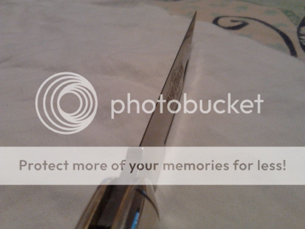

Hey guys,
Good discussions are going on in this thread regarding re-profiling. I dont mean to take sides on richstag and tripton's debate, but from years of experience solely using a grinding wheel, i can say that it is absolutely possible to get a clean even hollow grind freehand. This is the only way i do it. The size of the wheel and the thickness of the bevel dictates how "hollow" the edge will be, and it begs to say that sometimes the hollow part can be negligible if you are grinding a low angle (18-20degrees).
Back on topic though. I am so happy to say I received my first GEC yesterday! Im not used to having a knife with no cracks and spacing between the liners and handle, and such beauty! So i know many of you believe in working your knives hard, but this knife is so gorgeous im scared to take off any metal to sharpen it lol.
