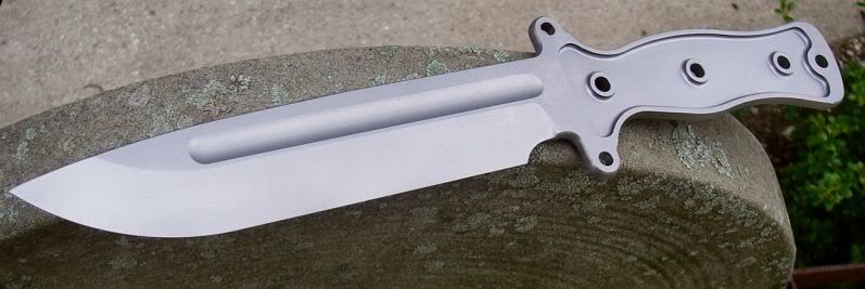

Going by this picture . Not much of the top gaurd could be removed to make the spine flat.
Make the spine flat? No. But, like I said, you can remove as much of the top guard as you want without showing gaps under the scales until you you start removing under the scales :rolleyes: because that's the only place where there are gaps. Hard to say going by just the picture, but knowing those tang holes are 1/2" wide and seeing how the width of the steel around them is about 1/3 of the hole's diameter, I would guess those walls to be 1/6". But if you want to flatten the spine, unfortunately you'll see some gaps because the gap extends behind the spine. However, you can technically remove the whole guard.

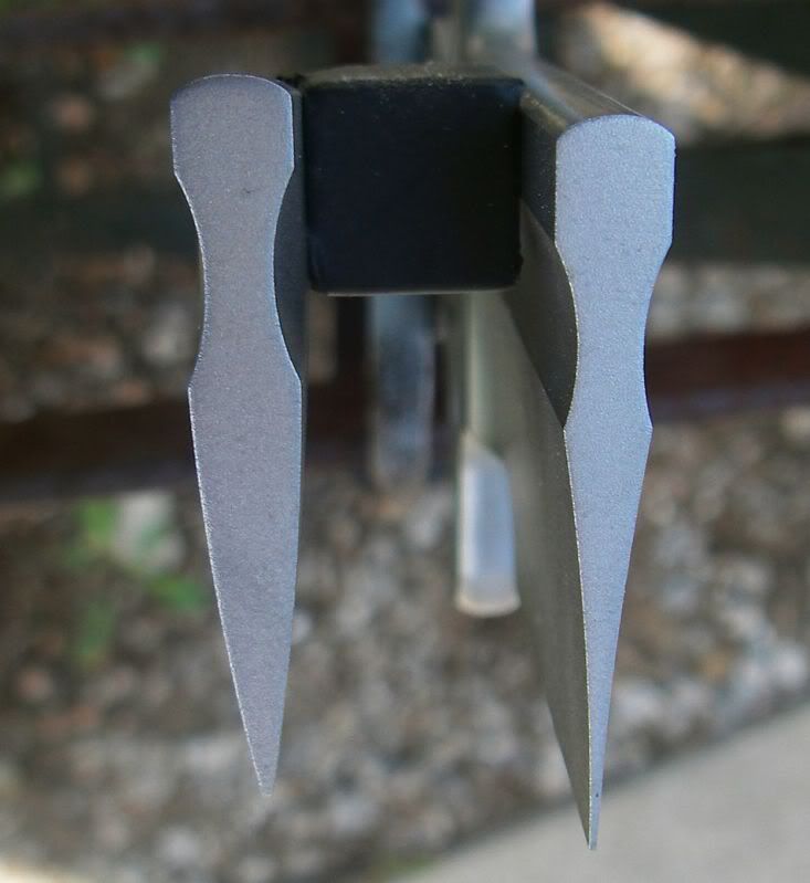

My questions is... will the knife with LB treatment be as tough as the original one? For example TG versus LBTG? I know that its a Busse after all.. but I am just curious. I think that the TG is more bomb proof but the LBTG will be a better slicer due to the grind, right? Correct me if I am wrong please. I am still learning. :) Anyway I will order one of these very soon!
The full convex grind of the 1st generation TG would be stronger than the large hollow grind of the LBTG. Under about any use but heavy prying it would not matter. I would bet the LBTG will be a much better slicer and be much less carry weight - Overall a superior knife except for ill-advised extreme abuse.
Here is a picture by Busse last year comparing the original to the proposed light brigade treatment.
The 1st generation is more like an axe or maul and the LBTG is more of a heavy duty slicer or knife.

So im guessing this grind geometry compromises quite a bit of strength. But im curious how much weaker it will be. I ordered this for my ultimate shtf kind of blade. Will I be ok using this hard?
You will be just fine its a bit thinner than the original but still thick and infi can really take a beating.
