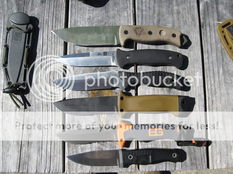

The Big Rock would have been a good basis for a survival knife.
I liked mine, just the grip was too flat for my paws.
Apart from that, it was a very good knife. No need to look further, in my mind.
Let´s see if Gerber responds, pulling this flawed "hollowed" TV design from the market (in a few years;)).
My thoughts exactly. Well, not exactly, I am comfortable with the slim grips on the Big Rock.
I really like the firesteel/whistle/sharpener on the sheath. Good concept(except the serrations), but clearly not "heavy duty" construction as marketed. Dissappointing for sure.
Horn Dog, it looked like a small diamond hone sharpener. Tell me, would it be capable of sharpening the serrations?
My big head-scratcher is why half the blade of this "survival knife" is serrated. :confused:
Bear Grylls personally likes partially serrated knives. The Gerber Gator he used in many episodes is partially serrated, other knives he used were partially serrated, and even the custom Rob Bayley was partially serrated. So naturally, the Gerber that bears his name, as well as the folders that are not yet available, are partially serrated.
I don't disagree that a serrated knife can be useful in the field. But I certainly agree that a knife that is expected to be able to be batoned with, but has serrations, is a contradiction. Each serration is a stress riser waiting for a catastrophic failure to happen. If somehow the blade cracks before the obviously cheap handle does, the serrations are probably where it will happen. Unless there's something else iffy going on with the tang underneath the handle.
Exactly. I also question the inclusion of serrations because of their difficulty to field sharpen without special equipment, and the included sharpener looks to be incapable of it.
As I said in my review, I prefer a plain edge to a serrated one, but Bear and others like the serrated edges, so I cannot fault Gerber for that. I have batoned wood with my LMF II and the serrated edge was not a problem. As for sharpening, one could use the diamond hone to sharpen the serrations from the opposite side they are ground on. It usually take quite a bit of use to dull a serrated edge. I don't consider the serrated edge a defect in any way. It's the weak handle material and the method of attaching the pommel that are my main concerns with the BG knife. The blade cut and was not damaged. The firesteel worked. The sheath is cheaply made, but it holds the knife.

Actually, we only have pictures of one failure in one test of one sample of the knife that seems to be related to the way this handle is built. A real full tang knife should not have suffered from this failure, that can be assumed.
The question could be why Mr. BG wanted to include a hammer surface on the rear end of the knife and how Gerber wanted to solve this problem without going to an integral construction that can have this in a satisfying way but would be extremely expensive to manufacture. I am not a rocket engineer, but there seems to be a basic contradiction here unless you screw or pin heavy plates to threaded end tangs. That happened with the KaBar, generally.

I like your review but the result was kind of disappointing. The pommel-construction seems to be very weak.
What knife is above the Gerber LMF? :)
