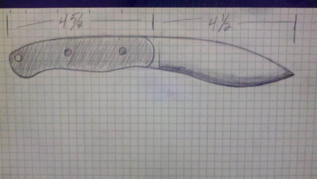

I just finished drawing mine up, but since my fiancee is using the desktop computer I had to take a picture of my drawing instead of scanning it. Still, I'm ready to post whenever the contest is open for entries

Here is my Wohlwend Wastelander concept. A 3-1/8" blade with a similar tip to my ASK, a full-size contoured handle reminiscent of a KA-BAR in shape with Micarta scales with rubber mat palm swell for a sturdy, grippy handle that is virtually impervious to the elements, held in place with three tubes and two pins. The grind would be full or high flat or full or high convex and would be either 3/32" or 1/8" thick 1095 or O1. If Mark forges it he could use a small ball peen hammer to forge the finger guard area so that the steel spreads out, making it even more comfortable because there wouldn't be a 3/32" or 1/8" piece of steel rubbing against your skin.

Man ya not gonna believe how close mine is to yours...it's freaky....shoulda posted mine first now !:rolleyes:
Lol, well now I'm really glad I got mine in first :P
Besides, Pit, if the blade isn't at least 2 inches wide nobody would believe that you designed it ;)

Here's mine. Inspired by the kukri. A little different but still not totally crazy. I call it the "Mini-Kooker." :D
Okay so this is my entry, I call it The Bush-tucker because I think it could do everything food related from processing a Whitetail or Squirrel, preparing ya freshly caught Trout for the campfire to cutting up hotdogs and salad veggies.
Although designed specifically for food prep the blade with it's slim sharp convexed grind would also lend itself to Bushcraft duty making camp tools, trap parts and fuzz sticks.
Not the greatest drawing in the world but I'm sure ya get the idea !

Ps...I should add my drawing means the blade is from 1/8" stock steel and it has a Micarta handle....not 1/8" Micarta !!!!
I like the mini-khukuri design, and I think that pitdog's design is quite versatile, even if it is still a behemoth knife :P

I don't mean to sound like a party pooper buddy but you really have to make an attempt at a drawing.
Your design sounds very cool so just have a go at putting pencil to paper, it doesn't matter how rough it looks as long as we can get an idea. I've seen some terrible drawings made into some great looking blades so don't sweat it !;)
