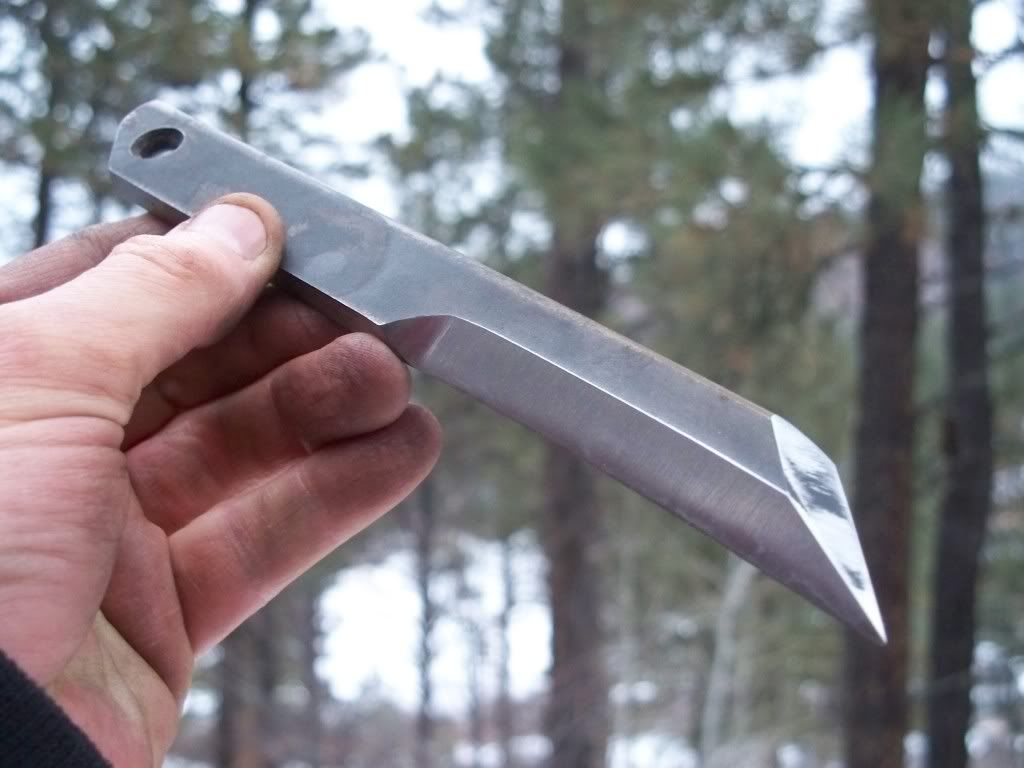

Orders - Custom .315 S7 chopper, a .315 D2 Tanto and a 5160 "reverse tip" tanto`

You know it! It is a cool design too, I have to do more of them! "Reverse tip tanto"

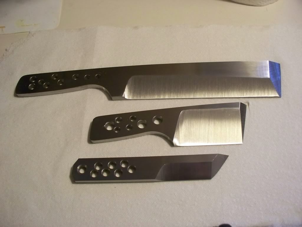

I did some heat treating yesterday evening and have the knives in the kiln for a second temper cycle. :D
Progress...
5160 reverse tip tanto
Pre-heat treated knives - ignore the grind lines especially on the big one, you have to leave them thick for heat treat.

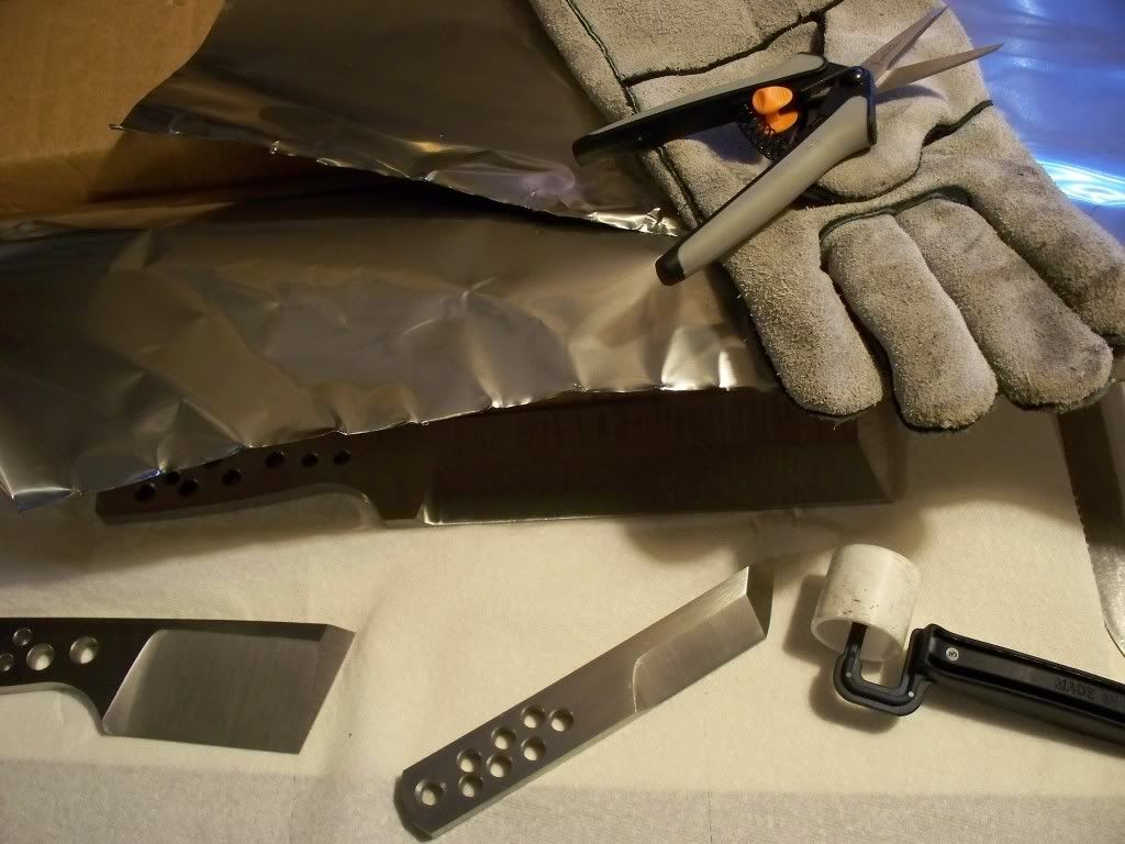

Cutting some stainless tool wrap for heat treat. Since these are air hardening steels they get very hot for a long time, 1725-1825 for 20 minutes or more. The wrap keeps out the oxygen which would burns the steel and remove the outer carbon skin or "decarb" the knives... the wrap keeps them clean as can be. The gloves are for hand protection, the wrap is thick and tough... one massive razor blade.
