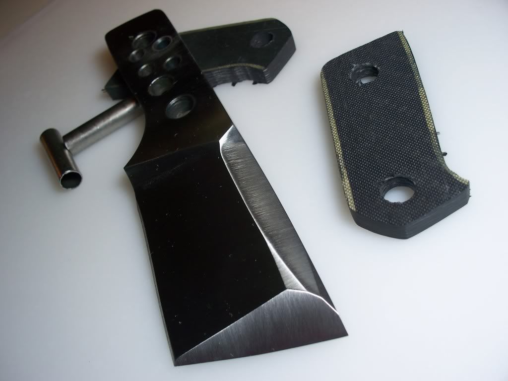

I am putting some carbon fiber scales on the mini cleaver, man they look cool! I have never worked with carbon fiber and it looks so awesome I will be using much more.
The carbon fiber was interesting, cutting the ends of 2 pieces dulled my bandsaw so badly I couldn't cut any more with it. I wore 3 layers and took precautions but I am still itchy too, it is like glass in the skin. Lol it looks so cool I'll get a Tyvek suit to cut it in if I have to! That and a dust collector for the new shop.

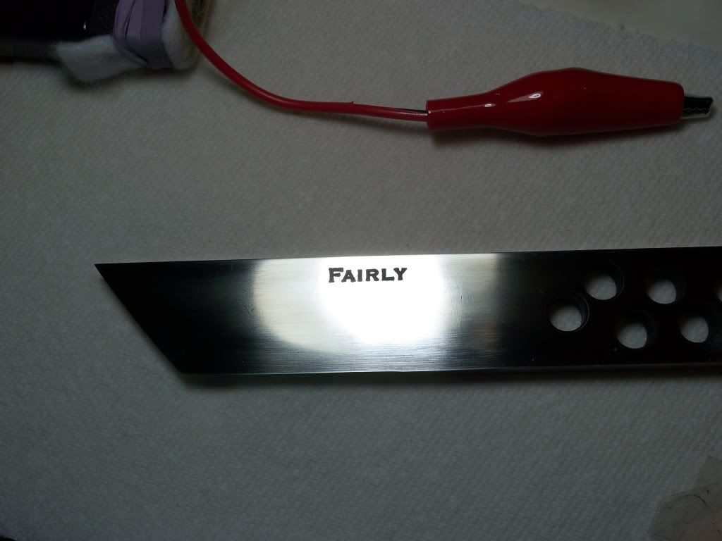

I'm just curious, do you know what rockwell the d2 was brought to?
Kaleb
It should be about 60-61 Rockwell. I think at this hardness you should have excellent edge holding.
try cutting it with a slow speed on the band saw?
I think that may be the way to go, either that or the stock blade came with isn't too great. It is just a little saw I intended for Kydex so next time I may go back to the wet saw, it saves my bandsaw blades and the diamond cuts really well. Thanks for thinking of me!

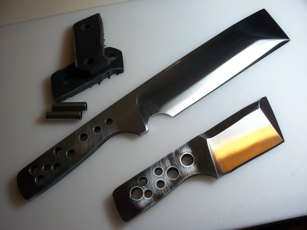

I have been working on the finish on these three for two days solid and it shows! :D
