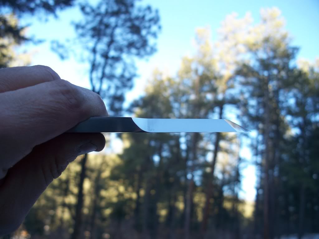

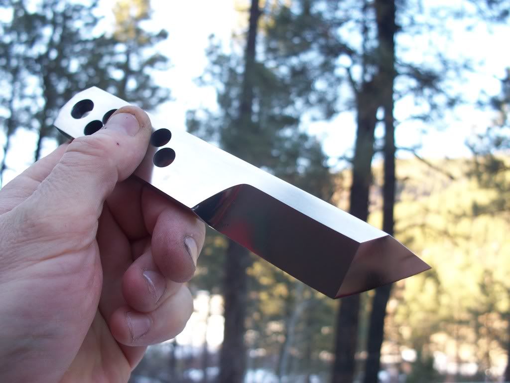

I have been out grinding today and have the big one closer, I should have yours and the others ground more tomorrow. It's so cold my grinding bucket keeps freezing over, lol! Cryo grinding...

Ok, what's the story on the small cleaver looking blade?
More D-2!!!!
