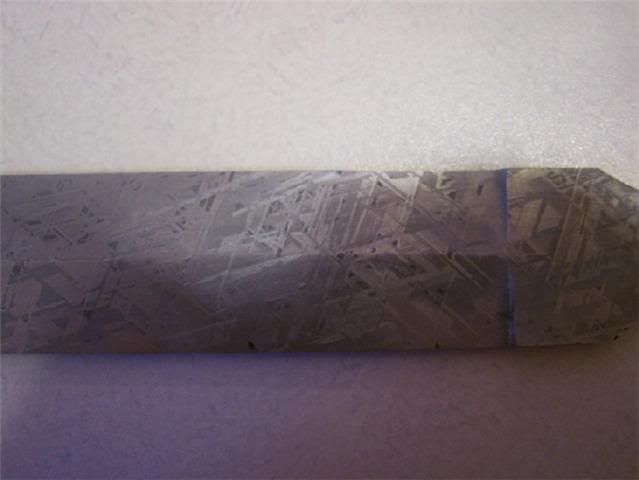

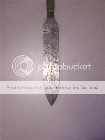

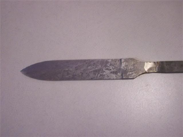

Delbert finished shaping and etching the blade.
WOW!!!!!
This surpasses my wildest expectations. Delbert is amazing.
I knew he was good, but he worked miracles with the meteorite slab I sent to him. Here are a few photos. Your comments are welcomed.

Wow! Del did a nice job and looks like a fantastic piece. Can't wait to see it all handled up!
With all the photos you take of wood Mark, I would have expected to be able to see the patterns a bit better. Did you mist it with water first so they would show up better? :D

You're a funny guy. These were Delbert's photos. When the blade arrives I will take more photos. I don't think we will need to mist it with water either.
Los Angeles,
I will not be heat treating the blade. The finished knife will be an art knife and not a user. Everyone says the heat treat will mess up the pattern in the steel.
Awesome project, nice work on the grinding Del! The pattern looks very 3D, the more you stare at it the deeper you seem to go!
