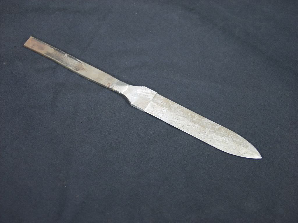

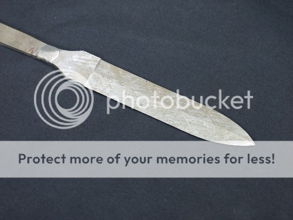

Delbert finished shaping and etching the blade.
WOW!!!!!
This surpasses my wildest expectations. Delbert is amazing.
I knew he was good, but he worked miracles with the meteorite slab I sent to him. Here are a few photos. Your comments are welcomed.
Now, I have to get back to work on the drawings. After that, the next stop is Fred Rowe who will be making the guard and pommell.
Thanks for the kind words,
Just wait ubtil you see it in person, the photos don't do it justice, just a few quick snaps before I mailed it.

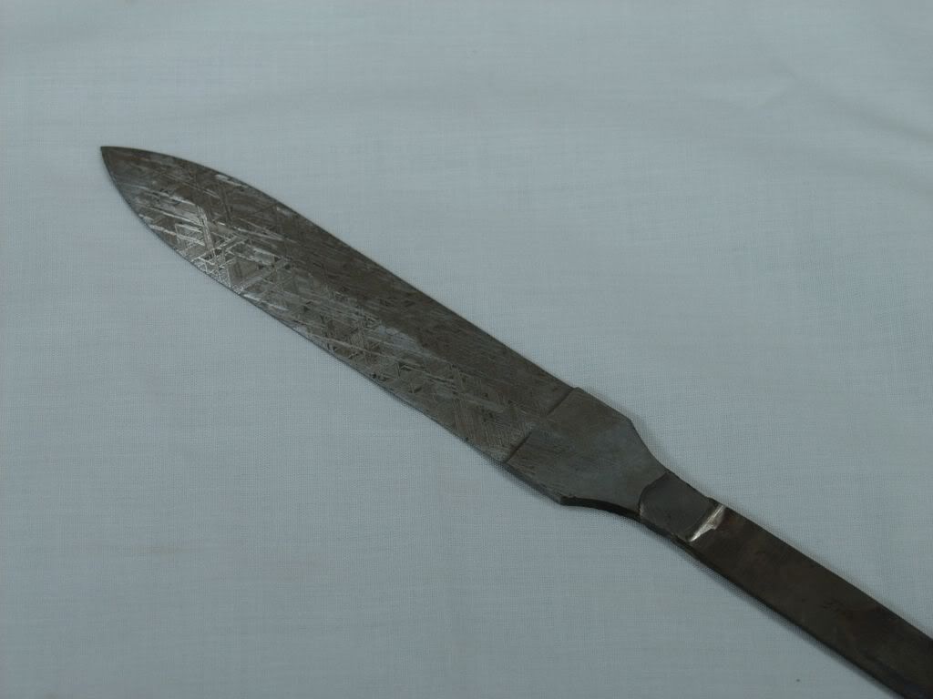

The blade arrived in the mail today. Here are a few more photos. This stuff is hard to photograph to make it look anywhere near as good as it looks in person. Once again, Del did a fantastic job on this. Thanks Del!

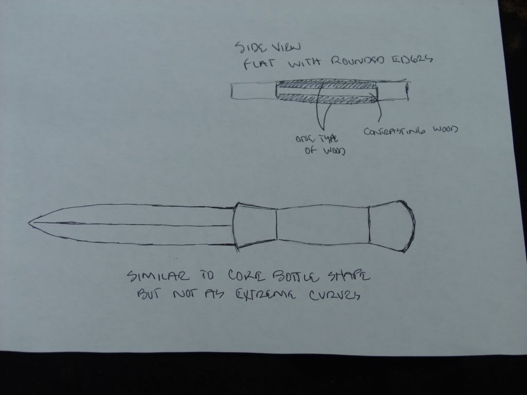

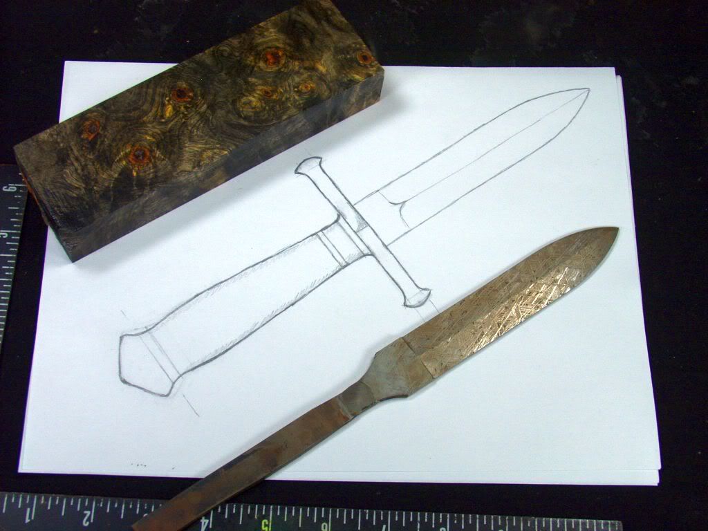

I decided to keep the design fairly traditional instead of going the fantasy knife route. Tomorrow I will be emailing drawings to Fred and Ken for their input. When we come to some sort of consensus I will post the drawings in this thread. After each phase is completed, we will post updated photos as well.
Here is the sketch I sent to Fred and Ken. We'll see what they have to say. They both will have the option to make any changes or refinements they see fit. The colors in the photo are off. Too much orange. The block in the photo is to show my idea of using dark buckeye burl for the wood in the handle.
The dagger blade is currently with Fred Rowe. He has been carrying it around a couple days to get ideas for the design. When we agree on changes I will post them for you to see. I am also considering using a different wood than the buckeye. Something equally cool but a bit more subtle.
We have come up with an agreement on the design for the overall knife. Using the blade shape by Del we sketched a few ideas that went back and forth between Fred, Ken and myself.
The main goal was to keep any component of the design from overpowering or competing with the meteorite blade. We wanted to keep it fairly conservative with out looking plain as well as provide a good pallet for Ken's engraving.
The sketch is a crude scribble but gives a better idea what will be the final outcome.
