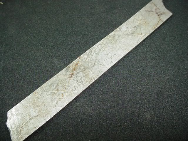

When Delbert shaped and etched the meteorite for the blade I was amazed!
What Fred is doing has me awestruck! The bronze he is using looks a lot like gold to me.
This is going to be quite the dagger when it's all done!
Thank you Delbert and Fred.
It's getting hard to remember it all started out with this.

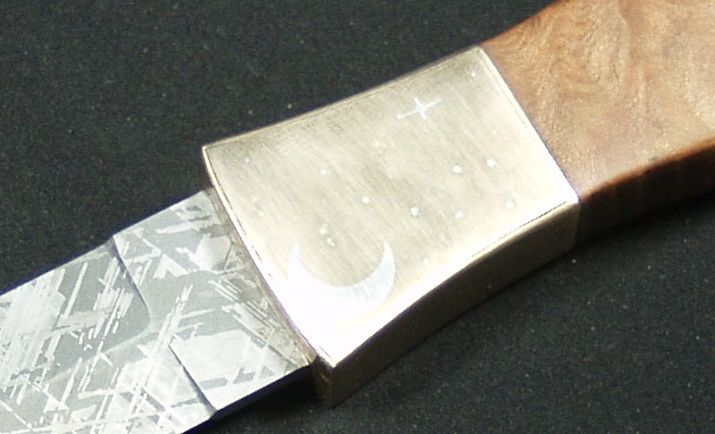

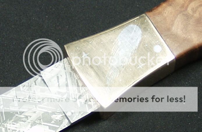

The knife came back from Ken Hurst who engraved and inlayed it with pure silver.
Closeup - Moon and Stars
Closeup - Shooting star and planets.
Beautiful and extremely detailed inlay.
