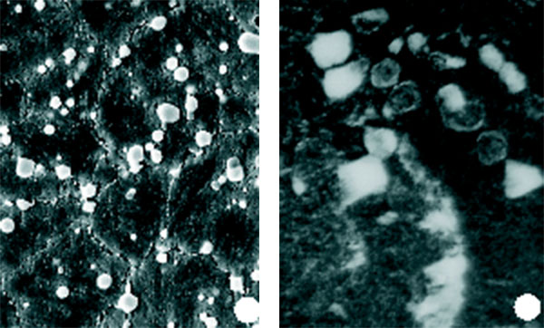

me2 - when using any type of manufacturer delivered microphotograph of steel, we need to ask ourself a question and try to find the answer.
What state is that steel in? Is it "fresh", sphereoised, austenized? Quenched martensite? Or tempered martensite.
Here is an example...
This image shows us HSS steel.
Left side - HSS steel after 100s in 1240°C, quenched.
Right side - HSS steel, after tempering.
See any difference?

So what has happened?
It was a trick question...
The pictures looks similar...
But the scale is not...
Left one is 2500x
Right one is 350000x.
NOW you can see the difference.

So is that cementite in the grain boundaries?

For those HSS pictures, what you are probably seeing is some undissolved carbides in the left picture (untempered) and bigger pictures of them in the right, though I suspect the difference in magnification means what we're seeing in the right are tempering carbides instead of undissolved primary carbides. Idaho knows for sure, I'm just guessing.

On the left -
MC and M6C primary carbides in HS11-2-2+Si steel austenitized in 1240 for 100sec, quenched. Carbides on the boundaries of (now gone) austenite grains. Magnification 2500x
On the right -
M4C3 carbides in the tempered (570C) martensite, HS6-5-2 steel. Magnification 350000x (dark field)
So no - these are not cementite.
