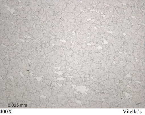

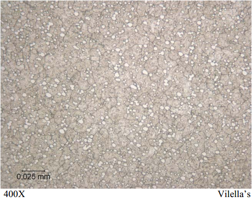

CPM vs ingot, cryo treated with the same HT protocol at the same facility. Two of the sixteen blades we did the CATRA test on.
[/URL]
Thanks for those micrographs, Hardheart. It's obvious that the powder steel has much finer, better distributed carbides, but I can't tell about the grain structure. Do you have a sense that the powder steel is finer grained? It looks like it a bit, but the grain structure on the powder steel is more difficult to discern than on the ingot steel, and I can't tell for sure.
Yep, spreading out the carbides makes the rest hard to see. I can see how the cpm versiin might be a little finer, but its not obvious. One would have to do the count and math to be sure. Just eyeballing it, both seem to be in the 10 to 25 um range, with a few smaller and a couple bigger sprinkled in for fun. HH can you reveal what steel that is?
We have edge-on SEM, cross section images in the resin for angle measurement (also done with a goniometer when the test was run), and metallographic images for all of them.
You have a great deal of time and resources tied up in that work Hardheart. If you get it ready for download please let us know. I'd purchase one for sure.
Joe
on the spec-metals chart SB wear and PD#1 are the same steel. Probably Cruwear for SB wear and PD #1 is, CTS version in powder form. Both steels are at rc 62 on the chart. I guess that's a decent idea of how powder steel can improve things a bit. Toughness is easy to understand. Why it gives greater wear resistance is still beyond me.
I'm one that actually likes D2 over CPM D2, and ingot Cruwear over powder cruwear. It seems to have better bite on some media I cut, such as rope. I sharpen both to around 200 grit, or if I'm using DMT's the extra coarse, whatever grit that is.
I don't actually think the wear resistance is that much better. It is just more even. In fact, one of the benefits of pm steel is it's easier to grind (rough). Wear resistance is tricky. There are some issues with matching the wear environment to the steel microstructure. Wear resistance is dominated by carbide volume and type. Both of these stay the same with PM vs. ingot versions of the same steel. Distribution of carbides and hardness are influential, but not as critical.
Distribution and SIZE are the major factors after volume, type influences size and hardness, but hardness is only critical depending on the abrasiveness of the medium being cut or the narrowness of the apex being achieved. Harder carbides can achieve a thinner apex-diameter and also resist cutting from the abrasive particles. Larger carbides cover/protect a greater area from abrasion, but a random distribution of such carbides can leave vast areas of soft matrix unprotected. As those areas wear down, there is less 'binder' to hold the carbides in place so they tear-out more easily, leaving a large gap of unprotected matrix behind which then quickly wears down until the next set of protective carbides is reached to slow the abrasion. With smaller, well-distributed carbides, you have a lot more protective plates covering the surface or apex (the meeting of 2 surfaces) and able to provide protection to the surrounding matrix. They hold the abrasive particles away from the matrix-surface, and while each carbide is smaller there is also less open space between them that needs protecting, so together they effectively provide more protection of the surface than a single large carbide would provide.
