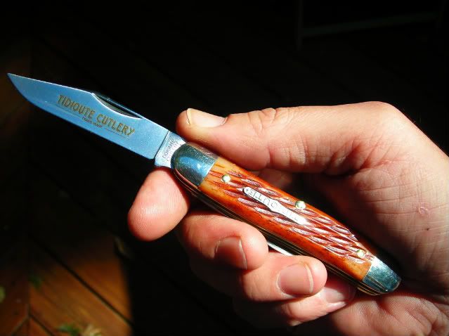

Can someone post a picture in their hand when they get it.
thanks in advance
joes
just came in:
case medium stockman for more perspective:
this is my 1st GEC knive and it lives up to the GEC reputation for quality and F&F. it is, and should be, a fair step above the case in most areas.
i kinda expected 1/2 stops but this one does not have them though there seems to be a hitch about 1/4 of the way down on the closing arc. hard to describe... walk is not smooth but i like to hear the talk. i was afraid the springs would be too stiff but this is not the case at all. also, the pen blade spring is a bit thinner than the main blade spring.
the main scale pin in the center of the knife is proud on both sides which i'm a liitle surprised at and there's a very slight chip in the bone on the pile side that most would never notice. the pins do bother me as they are right near the edge of the scale so i'll have to file them down a little. i'm very impressed with the color match of the scales though not so taken with the GEC jigging.
compaired to my case it's thicker but just as pocketable. F&F is slightly above case but i gotta ding it a little for those proud pins. the blades have a nice swedge on them that the stockman can't touch. the case has better walk but the GEC has more talk and overall feels heavy built. having said that, if GEC goes to make a stockman from this pattern it looks like they would almost have to add another spring (that's just a guess on my part) which would make it just a bit too thick for my taste.
i will buy another GEC for sure.

I got my ebony jack last night. Again, no half-stops, which was a surprise. Smooth walk and talk. However, the point of the main clip blade was sitting above the liner. A few seconds on the ample kick of the liner with a file fixed that. Aside from that one minor issue, this is a lovely knife. I like everything about it.
