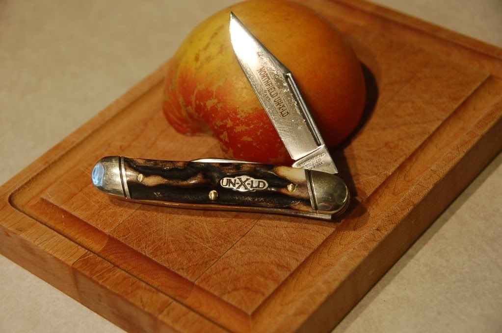

And here's the knife

Good lookin' knife, glad it worked out! :thumbup:
If you think about it, in the closed position the kick is resting and exerting a bit of pressure on the backspring. Now that the kick is a hair shorter than it was before it met the Dremel, the spring compensates and comes down to meet it by a hair as well. Or looked at another way, the kick isn't pushing the spring down as far as it did originally.
The stag is especially nice on your knife, Zippin! I like it when it goes bolster to bolster!!
Ja, lots of texture in there too. I bought it sight unseen and was obviously very pleased after running to the mailbox. Kudos to GEC. This model knife just works, plain and simple. It's firing on all cylinders and has quickly found a trusty spot in my edc rotation.
