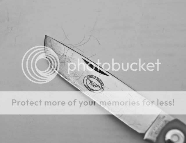

I decided to test the blade with some cardboard cutting today. I started off with light cardboard, actually it was just a cereal box. I sliced it down till there was nothing to slice, then I tested the edge. It still popped hairs off my arms and left me with a smooth patch. The edge would slice through paper with ease, but it wasn't as scary sharp as when I first got it. After that I moved onto some shipping cardboard, it's a good bit thicker and proved to be more of a challenge. But, the thin blade still screamed through it and I had a useable edge afterwards. It would take hair off and slice paper, but it started to loose it's perfect factory edge. I have it in my pocket right now and I trust that it would continue to be sharp enough for most jobs. As long as it's taking hair off my arm, I trust it.

The edge retention seems good, I have a way of using/loosing the factory edge quick. I like to get my own edge on there quick, it makes it more my knife. I use a 25 degree angle on my knives, I sharpen them with the Lansky system. It seems to workk really well for me. I have a #73 in 1095 that will cut all night, all day and into next week. It got a work out this deer season, it went through two deer and still shaved hair off my arm, even though it was coated in blood. I have a feeling this 01 will be about the same. So far, so good.
