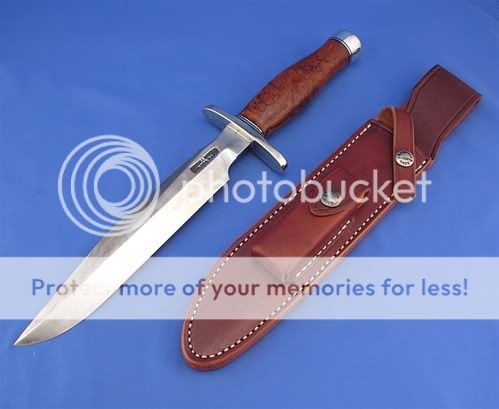

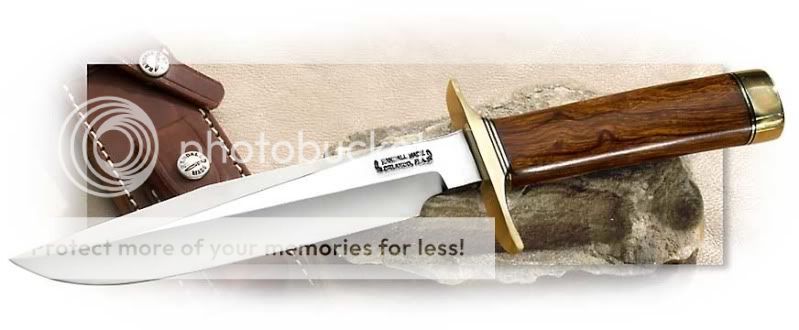

Well then start with the real deal, a Randall Model 1, it's had lot's of fighting experience back through WWII. Bones shouldn't bother it. I read here it took on a cinder blocks and stuff and was able to hang in with a Busse.
The Practical Tactical Forum is where you'll find the knife fighting experts so searching some threads there will probably reward you with some good information.
or a Randall 16

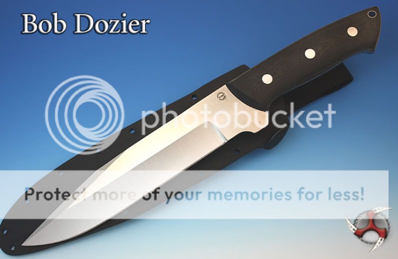

or maybe a Dozier fighter

Oh yeah, I think the steel on a carbon Randall is A2 but best to check the Randall site to make sure.
(Photos from AG Russell, gripsandknives.com, steeladdictionknives)

01 I believe.
