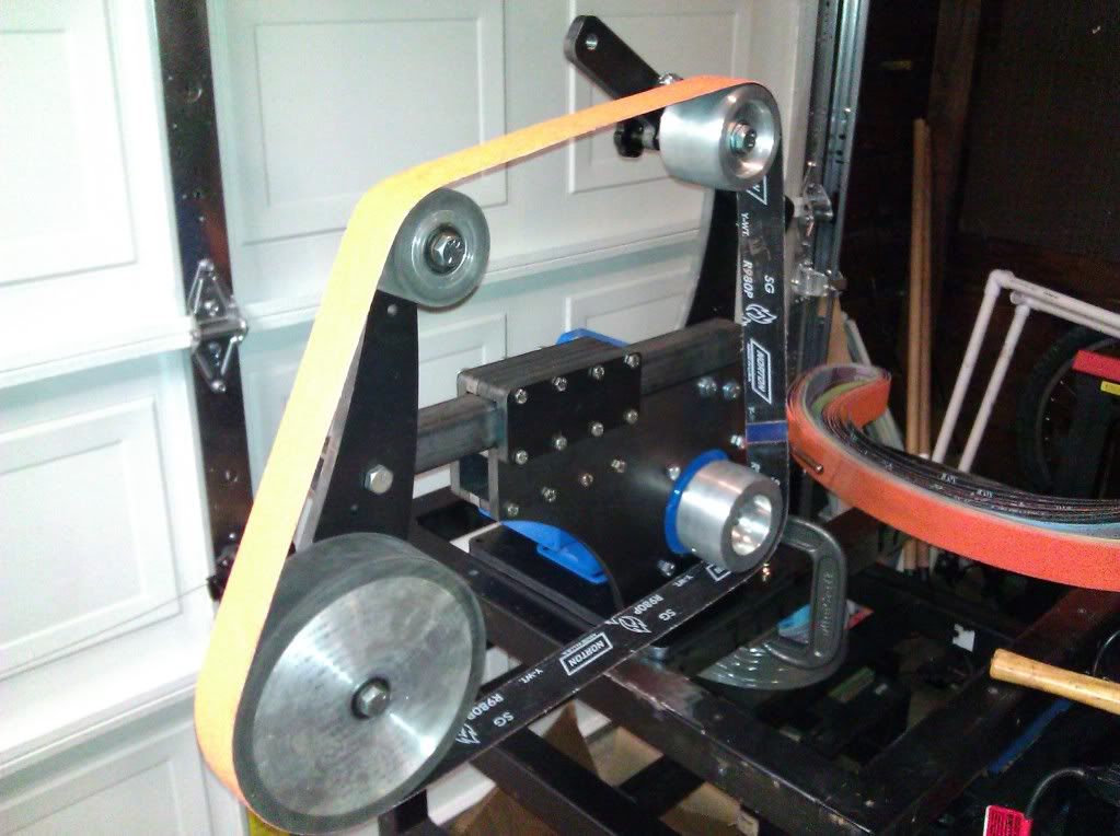

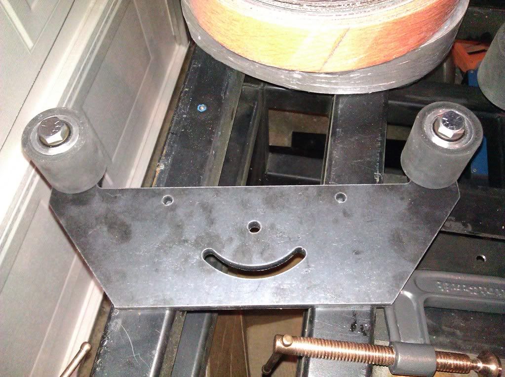

Had some time the other day to work on putting this together, and a little more tonight. Need a couple bolts, a spring, assemble my flat platen (that will go between 2" wheels) and then wire this puppy up! I'm quite excited!

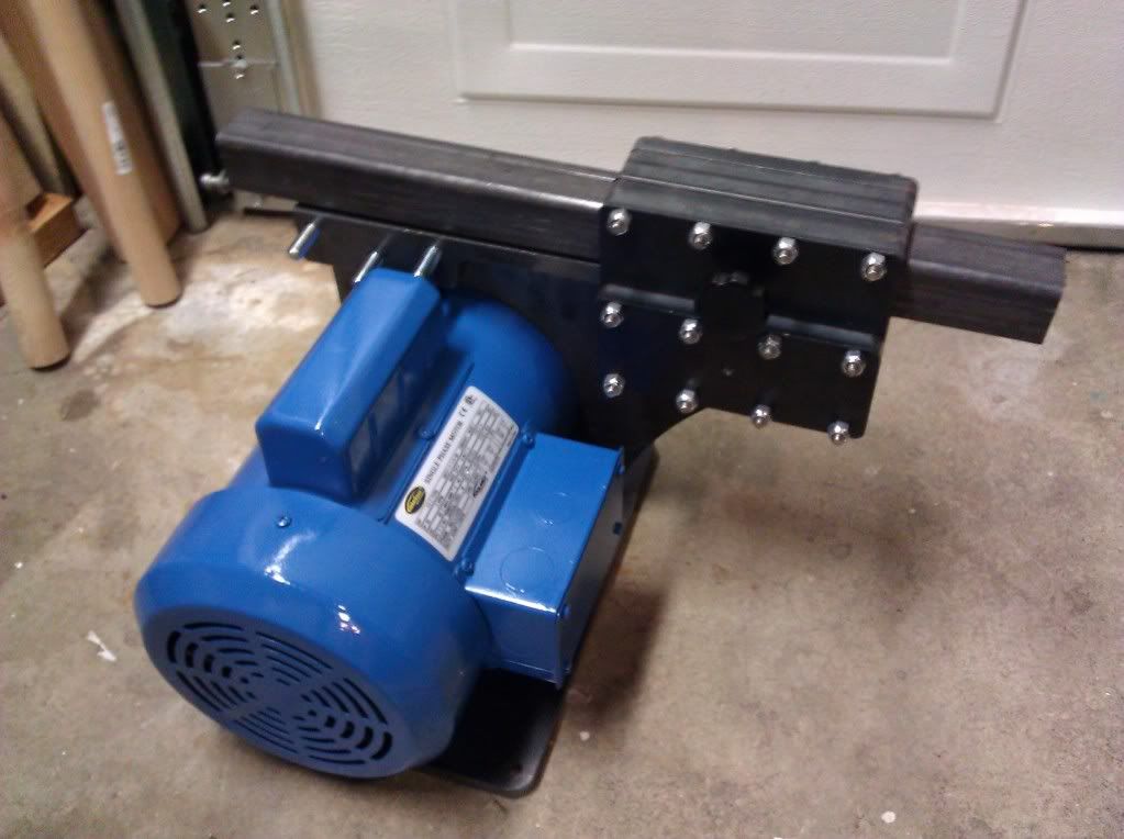

vfd's (IF you purchase the right one) turn single phase 220v into 3 phase 220v.
Therfore vfd"S are only needed if you purchase a three phase motor. If you do go three phase motor and vfd you get the great benefit of variable speed.
Or go single phase motor 110v or 220v and you get a single speed motor.
Chris
Chris and all:
I am trying to get my head around single phase -v- 3 phase. Call me an idiot but can I actually use a 3 phase motor if I don't have 3 phase power to my shop? I am reading about the VFD and it seems that you all are saying that a three phase, with the VFD will allow for it to be run in a traditional home shop that isn't equipped with 3 phase power. Are you able to clarify this once again because I have a really good line on two new 3 phase motors that I might have to pick up if it will work in my home shop. Thanks in advance
Dirk
Nobody us going to have 3-phase ran to your house, you'll have single phase. A VFD will convert your single phase to 3-phase and allow for variable speed and consistent power...
S noo, you don't need 3-phase, that is what a VFD is for. Just make sure if you're going to use a VFD that you get a 3-phase motor, otherwise a single phase motor is fine.

I've read through the original thread, and this one - I can't seem to get my head around how the standard platen goes together from the nested .dxf patterns that are found on blindhogg's site. Has someone got a picture of the assembly they can pop up here to set me straight ?
And second question - has anyone ever got a plasma cut version of the parts and how did it turn out? I have an acquaintance that just installed a high definition plasma table and I think I can call in a favor to get him to cut the parts for me for free :D I think the machine is accurate to about .015" but the small holes may be a problem - I might have to cut them myself. Maybe the machine can do a simple piercing for a starter pilot hole for me.
Thanks for the great resource and all the useful info in here !
Lewis
The plans on my site Blindhogg.com does not include a platten. I never got around to creating one of them. But Jamie at polarbearforge.com does sell just his platten alone if you like to get it. I do believe a plasma would work, you might have to dress the edges with a sander or grinder, but should work out for you. Give it a go.
CW
LHC, greetings and welcome!
As Chris said, I do sell the platens supports separately. They are $20 apiece plub $10.50 shipping.
Depending on how the pierce looks, using it as a pilot is a good idea. I've done that from time to time on different projects. If the pierce isn't the nicest, you can also cut the profile and then just spot and drill the holes.

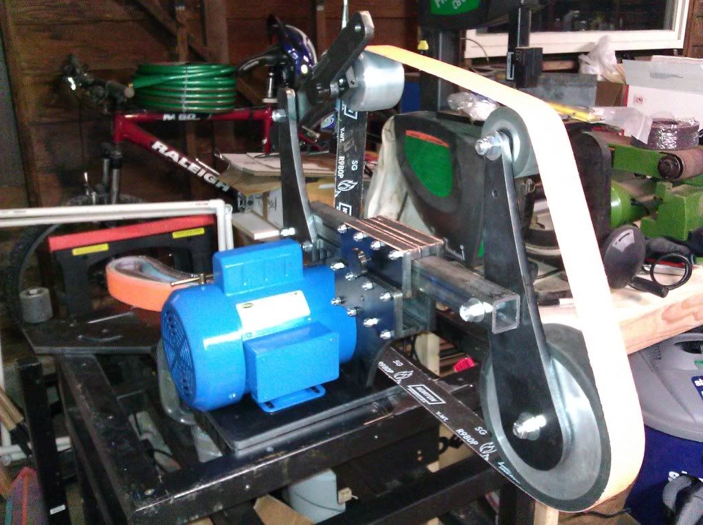

Thought I would show off my recently finished GIB kit. Finally got it all together and did alittle grinding with it today. Real happy with it and the second tooling arm slot sure comes in handy with a separate toolrest.
Chris
That grinder very nice. I really like the Tool Rest on that grinder. Better than my KMG! Might have to try something??

I have had my GIB and wheels for almost a year. One thing after another has kept me from finally getting it together. But seeing as how I have set my old belt sander that I use for a grinder on fire a dozen times lately, I am finally pulling the trigger and getting it together. I should be picking up my motor tomorrow. It's just a single phase 110 2hp single speed 3450rpm motor. Eventually, when time and money allow, I'll replace it with a variable speed motor. I'm going to mount the grinder on my Rockwell JawHorse. It's stable as hell and at the height I like to work leaning against my stool.

From what I have experienced with the various rotations of the multi platen and how much belt tension is needed I got a tooling arm 18" and a work rest piece that is 22"
I got a piece of thick walled tubing first and it ended up being bent, now I have 1.5x1.5" solid and it is much better
