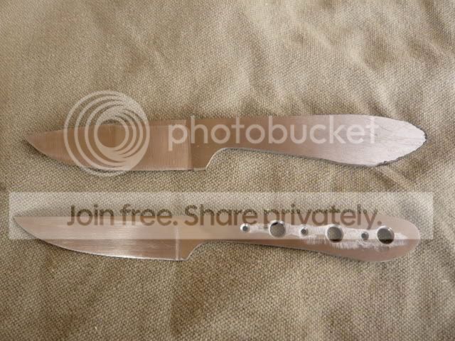

Grinding diagnosis/troubleshooting requested

I have exactly the same issue with my Sears 2x42. My plunges look identical, i.e. the right side is more curved than the left. Since I'm new at this I just figured I didn't know what I was doing. So, I built a jig that would hold the blank at the desired angle, extend the grinder table, and even used some small pieces of carbide for a "file guide" type arrangement. Oh, and I have a ceramic platen. The problem still exists.
What I have observed is that when grinding on the left side the belt moves to the right just a bit after a little pressure is applied. I'm not sure if this is an inherent tracking problem, a belt problem, or my less than spectacular technique. I'm going to try some different belts to see if that changes anything.
Allen
Allen if there's room on the idler wheel put a line of tape in the center of it to increase the "crown" of the idler wheel. Just a couple layers of masking tape can work wonders.
The problem with the bevel is all about pressure. Direct pressure right where you need it... back off where you don't need it.
Will,
Thanks for the tip. I'm headed to the shop to give it a try.
Will,
I gave this a try. Two layers of tape, 1/8" wide, down the center of the idler helped. The belt stays put much better than it did. I obviously didn't get the tape aligned straight since I induced a bit of side to side wobble, but that can be corrected. The idler has precious little crown to it, so no wonder the tracking wasn't the best. There was also a bit of side to side wobble before I put the tape on, which tells me that the idler crown was far from being true to begin with. Guess a guy gets what he pays for. A better grinder would be nice, but I need to get a few knives under my belt before contemplating making that expenditure.
Thanks again for the tip.
Allen

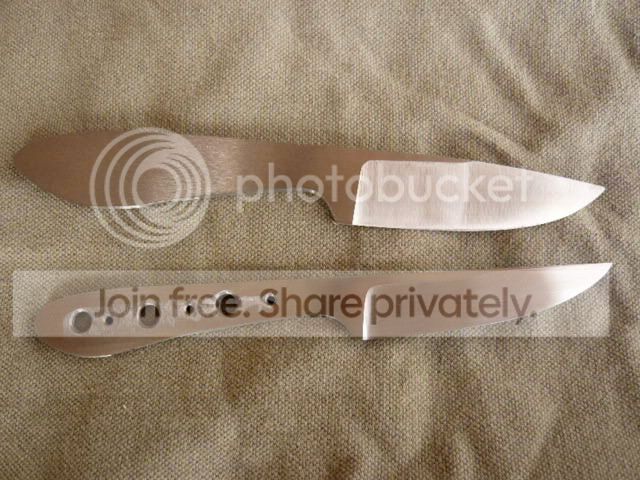

I ground another blade this morning, trying to keep in mind everyone's comments, and my own theory about grinding the tip to proper thickness. I think I may be onto the problem with the tip issue, looking at the results from today's blade. It's better, but on both sides rises up at the end. As I get out towards the tip, I sort of tighten up and I'm not sure what to do. In my head, it seems if you apply more pressure and/or pull the butt out to thin the tip, then the grind will have to go higher/deeper....yes, no???
The top grind lines are not PERFECT, but I think between some more practice and some hand sanding that will get better. Unfortunately I did not take pics of the first blade fresh from the grinder to do an exact comparison (the first blade had been mostly hand sanded to 320x for HT, the 2nd one is fresh of the grinder with a 400x belt.)
I used an unsharpened pencil as a makeshift push stick on these two, experimenting with both the eraser end and the flat wood end. I think slick is the way to go, so I'm going to have to figure out where to get some of that UHMW polymer.
I just 'kissed' the flat above the grind towards the end with the 400x belt being sloppy, but I think you can still make out the grind line. It should sand right out.
Thanks again for everyone's input!
