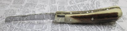

I've just been sharpening one of my Sambar models, so I might carry this one tomorrow :thumbsup:

Wow Jack!!!:eek::eek::eek:
Thanks Paul! :D The Indian Government's export ban on sambar stag has hit the Sheffield cutlers real hard, but occasionally they manage to get hold of some, and I was lucky enough to come across a few nice examples while visiting the factory. Here's the pile side of the one I'm carrying today :) :thumbsup:
