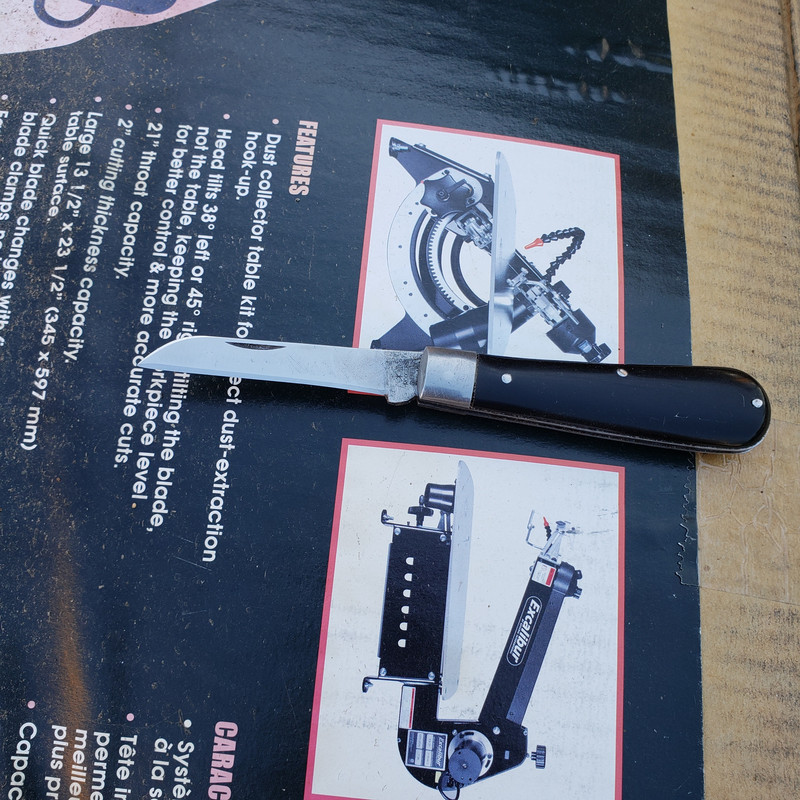

Looks better than the original! Beautiful work!A while back, an accident befell my favorite and most carried lambsfoot and its tip was damaged. I gave it a quick repair and resharpening at the time and put it back into service. But it was not a full repair, and I knew I'd eventually have to revisit it. I think its most recent sharpening must have further weakened the tip and recently I noticed that it had gotten worse:
Well, friends, that simply won't do! An acute, super sharp tip is a hallmark of the lambsfoot blade profile, and it's far past time that this beloved one be restored to a proper profile.
I had a bit of free time today, so out came the files and diamond plates. With a bit of patience and elbow grease, the damaged part of the tip was removed:
But... we lost the swedge.
No worries, we're not done yet! After a bit more grinding work followed with som cleanup on the Tormek honing wheel, I'm happy with where it ended up:
I despise clam shell packaging, but I'm actually looking forward to the next one I have to deal with. This tip will show it what's what for sure.
But, I better not drop this knife again! I don't think there's enough room in front of the nail nick to do this again!

The newly rehabbed Lambsfoot performed admirably in today's task, breaking up cardboard boxes. I must admit, sharpening it on a Wicked Edge system can be a bit difficult because the blade is rather narrow. This holds true for pretty much all knives with narrow blades since my preferred angle is 15 degrees per side. Oddly enough, I don't have this problem with the new AW Lambsfoot(s), there is enough blade width to hold them securely in the vise and still be able to sharpen (many times reprofile) at 15 degrees. I have a Tormek attachment for pocket knives but it was put away in a box during the move to the new house and I haven't had the time to look for it. Here it is at rest, before quartering the last panel of a large box.![]()

Great work there. The same happened to my small swayback, the tip 'rolled over' but I couldn't recall how I'd done it. Luckily I didn't have to resort to surgery, but if I had I doubt I'd of made as good a job as what you've done there.

Superb job Greg![]()
Wow!Really nice work Greg, you're obviously getting on well with that Tormek grinder
I'd definitely echo your final comments, a Lambsfoot loves to be used
