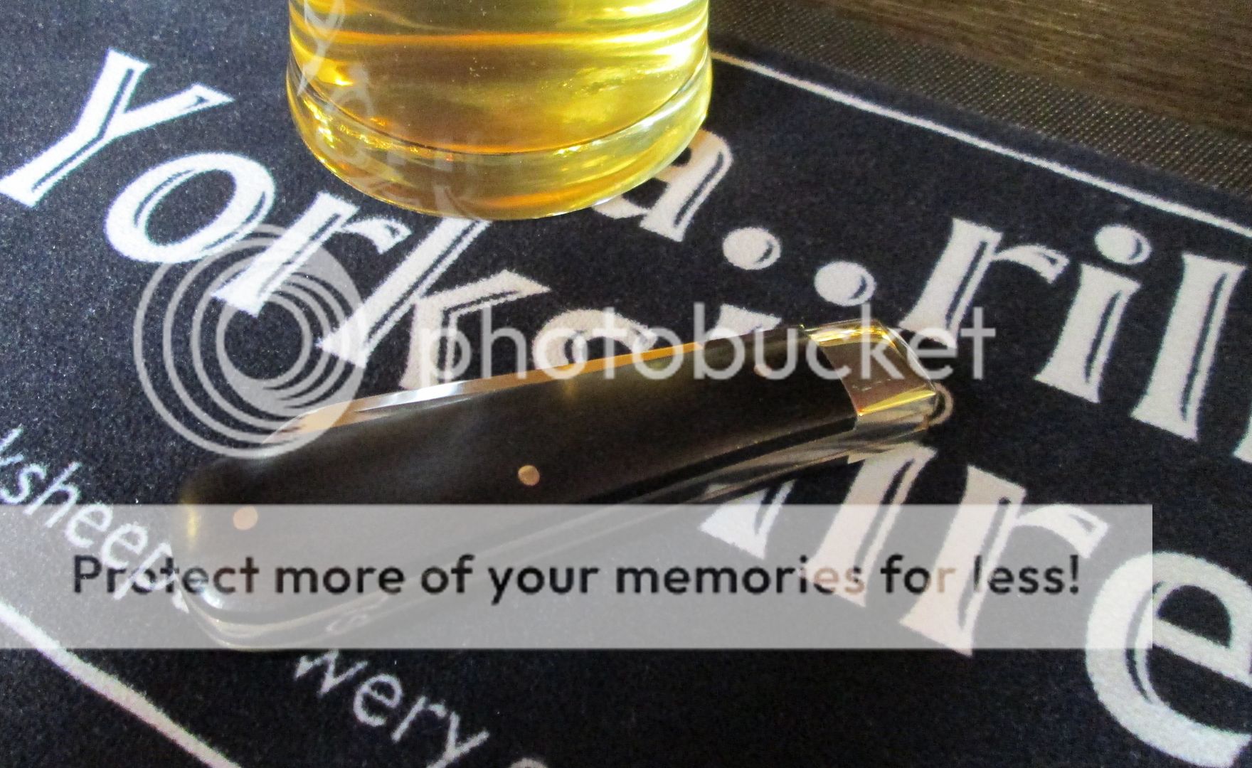

Nice to hear Texas was represented. :thumbsup::):thumbsup: I'll bet your friend was happy to enjoy some cooler weather, too. (I know I would enjoy it)
Oh yes! :) Tyler has lived in Leeds for a few years now, he's our most famous Texan :) Hope you get some cooler weather soon r8shell :thumbsup:
Hope your day was very Yorkshirey, Jack and that you can finish it off with a few tasty pints.:thumbsup:
Thanks a lot Mark :) Yep, pints, Yorkshire Pudding, Lambsfoot, flat-cap, white roses, the whole works! :D I did take a few pics, but looking at them now, they're pretty rotten, and mostly blurred! :confused: :D :thumbsup:
