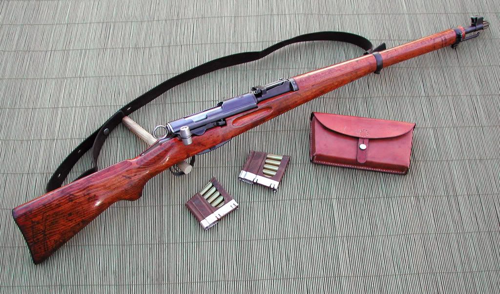

AdAstra got me thinking about guns with his military surplus posts (Thanks Mike
) so I picked up a nice 1955 model Swiss K31 a while back. Beech stock, beat up as usual, but a nice bore and no rust. Now I know you're supposed to leave them as is, but that's just not me. I've got............urges. Usually involves TruOil and sandpaper, and gun blue, etc. I know it's heresy, but she looked so...sad.
Tried not to make her look new, the TruOil looked too plastic, so I toned it down with some 2000 grit sandpaper, then a rottenstone rubdown. Hit some of the worn hardware with some Oxpho-Blue from Brownells. First time I've used that and it's excellent stuff. The cartridge box is from the newer Sturmgewehr-57, but I didn't know better at the time.
