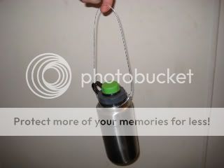

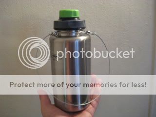

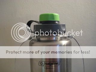

Mistwalker, these pics aren't the greatest but you get the idea
Nice!
Did you slide the loop inside the stopper? Both loops should be inside the stoppers.

You probably got it, but for those reading, I will explain it, just to be safe...
The bail consists of one piece of wire rope, with each end connected back to the piece with a loop. These loops give the bail the convenience of being removable.
But, in order for the bail to be secure on the bottle in use, the loops have to be kept from moving away from each other allowing the bottle to slip out.
So, I place stoppers on the line, so that once the loops are inside the stoppers, the 'snare' if you will, is small enough to stay secure on the bottle.
I did not send instructions out with these bails, and I should have.
