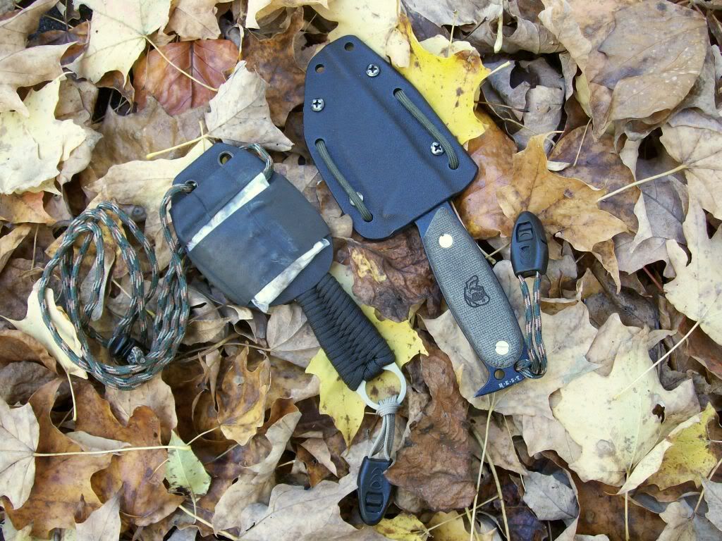

Pics as promised.

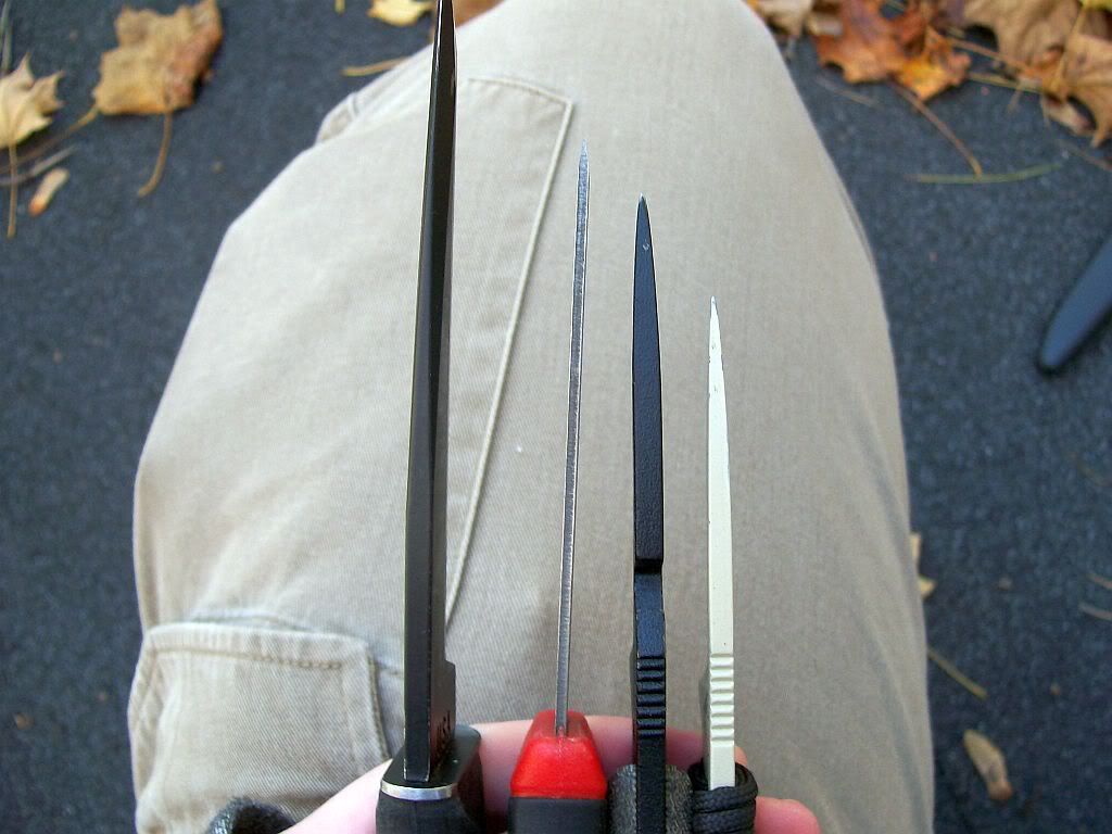

In a row, left to right, Ka-Bar Short Tanto, Mora Clipper, HEST, Izula
Top down, perspective scews it a bit. The HEST is the thickest, with the Ka-Bar close behind.
The Mora and HEST are a close match in overall size.
Izula and HEST lined up at the finger choils to compare blade size.
HEST and Izula (in custom kydex) sheathed side by side.

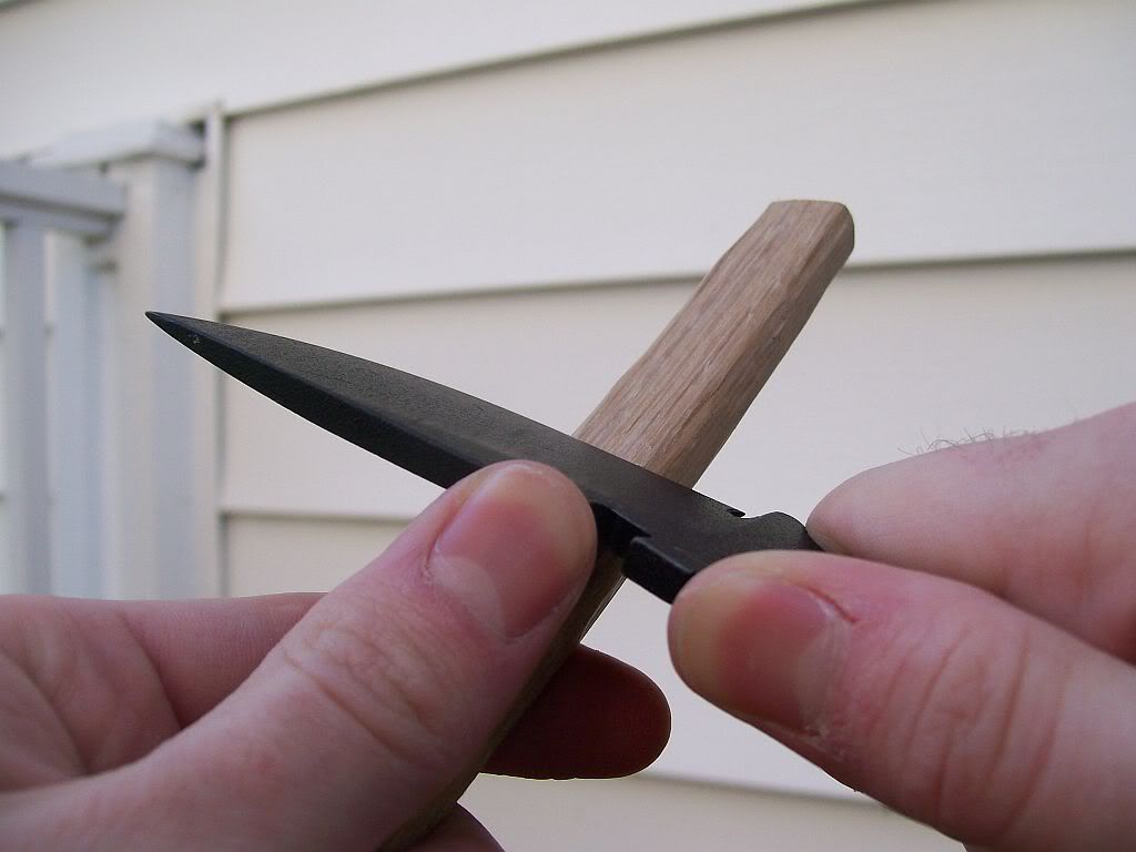

This is why the bottle opener annoys me.
I tried a bit of whittling, I tend to push the blade through with the thumb of my weak hand, hard habit to break. Every time I did that it ended up getting pinched.
This is the grip I talked about which is comfortable and intuitive for me. Lots of control.
Oddly enough the bottle opener does NOT dig in when you do this.

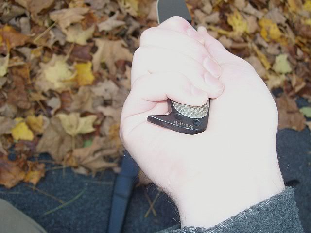

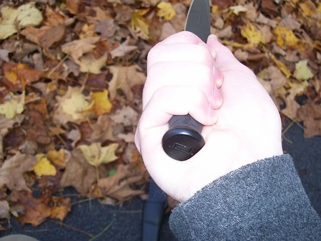

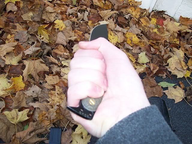

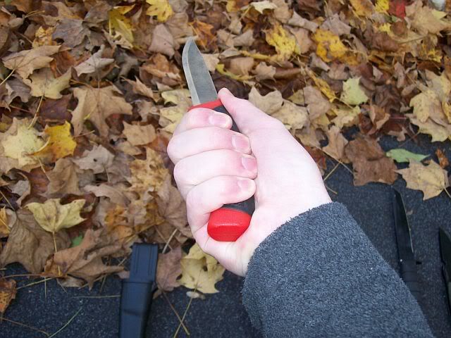

These didn't come out good, but hopefully I can explain my minor complaint about the HEST grip. I don't want to make a big deal of this, but since I brought it up I'm gona make sure people understand what I'm talking about.
These next three are all in a Saber Grip, that is, fingers wrapped around, thumb on the blade spine.
HEST. See that gap between pinky and the handle? That's uncomfortable.
Short Ka-Bar. Pinky touches handle and wraps nicely.
Mora. Awesome fit.
Interstingly the gap with the HEST goes away if you switch the a hammer grip, that is, wrapping you thumb around instead of putting it on the spine.
I think the whole thing is due to some odd interaction between the geometry of my hand and the thumb ramp. (My hand is 7.4" long and 3.5" wide)

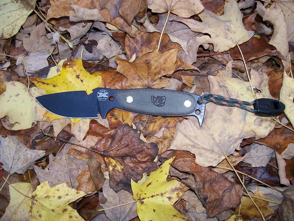

Here she is, one last time, I'll miss her.

Joben, I like how you held the Izula up to the HEST, gives me a great heads up to what to expect (thought it as bigger actually!)
Good stuff Joben. Excellent review and pics. Can't wait to get my paws on this knife (I'm dead last on the pass-around).
I thought it was bigger too, that comparison actually surprised me. The HEST somehow creates the impression of being bigger than it really is. I think this must be what people mean when they talk about 'little big knives.'
