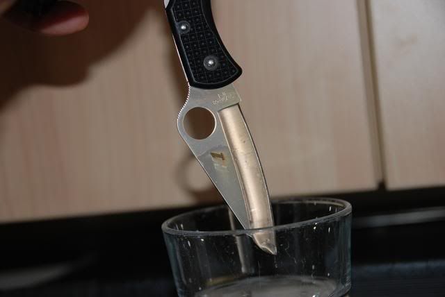

Regarding the blade stains, I don't know how much truth there is to this, but there were previous reports of staining on the H1 blade (Benchmade, no Spyderco product). They wiped off with a little cleaner and never showed up again. The theory was that after finishing grinding one set of knives (not true stainless like H1), if you started grinding a batch of H1 blades, the first few might catch some tiny bits of other metals, which would then rust on the blade. They could be wiped off without any visible damage, as the H1 wasn't actually rusting.
The pitting is hard to explain, but if you have ever exposed the knife to chemicals, it can corrode.
Here is an H1 that was left in chlorine:
Beautiful! I love that patina. :p :D
I doubt he was fishing in pure chlorine. I'm glad someone finally found something that would rust it, I was about to let mine swim in some muriatic acid overnight.
