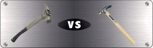

D) Put in some good time with a Ti hammer. Give it a week. You won't believe what you can do with it.
:encouragement:
It makes no difference what the head is made out of. It could just as well be a rock. 16oz is going to drive a nail like a 16oz hammer. All things being equal. You would be better off if they would come out with a with a 16oz steel framer with a big face much like a sheet rock axe. At least then you would have a sharp milled face that would last twice as long and cost half as much. But the head would look small and well........you know what I mean.
I can sink a 16D nail in 2-3 hits with
a 14oz Titanium Hammer all day long.
Can that be done with a 14oz steel hammer?
What makes you believe that titanium will drive a nail better than steel? You put a 14oz steel head on the same length handle and you will swing them both at the same velocity. Same velocity, same mass, same result.
Experience. Actually "doing it".
AND, if you say "same", then you're STILL doing it with MORE weight than necessary.
AND, that proves my point that you can do "more" with less with a Titanium Hammer.
(Remembering that force = mass x acceleration, you can give up some mass if you pick up acceleration)
In one of my responses to you, I actually POSTED an all steel 15oz hammer that IS as long as the Titanium 15oz hammer.
The DeWalt/Stanley FatMax Hammer. How did it do? Not as good as the Titanium Hammer and even when it was remotely
close to the Titanium Hammer it STILL transmitted far more vibration and shock to the user. And, it was far more flexible
and not as stiff as Titanium.
(again, due to the properties of the metal)
"When compared to a wood handled titanium headed model, the titanium hammer still wins for its ease of nail driving,
But when we compare the DeWalt to other steel handled framing hammers, the MIG Weld does seem to have an edge over
the competition. When swinging the DeWalt DWHT51138, the head is noticeably lighter than a similar one-piece forged
steel hammer and we felt that the amount of effort required to sink nails was considerably less.
An all steel hammer? There is not a worse more inefficient hammer invented.
even when it was remotely close to the Titanium Hammer
And, it was far more flexible and not as stiff as Titanium.
What do you know about shock and vibration? You are the same guy that didn't have that problem with an Estwing.
Titanium, the magic metal that makes you swing harder. And you bought it?
Bought it, used it and proved it.
Nothing speaks louder than actual experience with a product.
BTW, correction on what my Roofing Hatchet weighed.
I stated 32oz. Actually, it was 42oz.
No wonder I have forearms like this!

(Just one note, with the Titanium hammers, you have to give them more than just a 15 minute try-out.
I'm sure you appreciate the value in first learning how to actually use a tool before judging it. I'd say give it
a few days. It's common knowledge that Ti has different properties and must be swung in a different manner.
With Ti, you're not just lifting and dropping it; you lift and swing it faster to the nail.)
Titanium VS Steel
"Nobody disputes the advantages of titanium: it’s as strong as some steels and weighs about 45% less. In a hammer, the lighter weight means a faster swing and a more powerful strike. So a 16oz titanium hammer will actually drive as well or better than heavier steel hammers. (In case you’re wondering how this is possible, look at the physics: the energy of a hammer strike is equal to one half the mass of the head times the square of the head’s speed at the time of impact. In other words, the energy increases linearly with mass, but exponentially with speed). Not only do titanium hammers use energy more efficiently, they’re also better at absorbing reverberation and reduce stress on the arm and shoulder.
So we’re back to the original question: is titanium worth the money? It just depends on why and how often you use that hammer. $150 doesn’t make a lot of sense for weekend projects. But there are a lot of professional framers who swear by titanium, despite the price tag. And I don’t think it’s because they “bought the marketing,” as some detractors claim. A lighter and more efficient design counts for a lot if you use that tool 8-10 hours a day, 5 days a week. And it really counts if you have chronic shoulder injuries (which, after 8-10 hour days, is pretty likely.) The “Titanium vs Steel” question is less “Pepsi vs. Coke” and more “Explorer vs Escalade.” It’s the way you use it that will or won’t justify the cost."

The whole "costs more, lasts less" argument is pretty null today with most tradesmen using guns.
Hammers just aren't being used as much as they were and last significantly longer with less wear.
I've seen Titanium Hammers being sold for the $50. mark on sales. That's only $10. more than steel.
For those who care about it, they are literally lifting tons of less weight per day by using a Ti hammer
instead of a steel hammer and all that "less" lifting is beneficial to the user (not to mention the less
trauma they are exposing their ligaments to). Steel is real, but now, it's also archaic technology.
If I had to rely on one hammer to last me for the rest of my life (and not use guns), it's be steel.
But, in the "real" world where I do use guns (and even when I don't), it's a no-brainer.
Same performance less weight, save my elbow, risk of injury greatly diminished.
Just like the article says (and I've always said)...value is relative.
It depends how a person is going to use a hammer.
