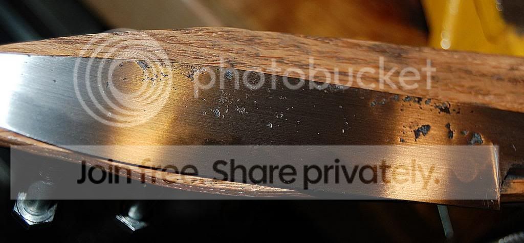

Well I ordered some of the 600grit and 1500grit abrasives to give a try(already have 400). Hopefully that will suffice. ill try and post how it works out for me. Got this hamon to try and polish out. Did this guy with my last piece of W2 (aldos old stock) a little bit of some clay stuff and quench in parks 50. Was gonna be kind of a forge finish but ended up taking more off so its now just kind of rough lol. I forged this one to shape pretty exactly as far as forging goes. the edge was darn near thickness of a penny tops which is the closest Ive forged before.
Great thread by the way and thanks to all the contributors.
By the way this is only a rough 220 grit sanding.

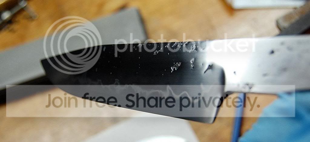

Sorry dont mean to derail the thread. So I got one side up to about a 1000grit. So trying a few things suggested here. Once up to grit I cleaned that side with goofoff then used one of the makeup remover pads and lemon juice. Just rubbed it up some repeatedly for maybe 20 seconds. Cleaned with windex. Then I used a couple of polishers I have, mothers which is a little abrasive and another which is much smoother. Did this primarily above the hamon line. Then I repeated once more. I think it turned out pretty good so far. Nothing like a traditional polish but then again I dont have that time right now or the know how or the tools.
Im hoping to get the 600 and 1200 or 1500 grit abrasive tomorrow and wanna try playing with that on this one. See if I can get maybe a little bit of difference from above and below to contrast either side some. Thanks Nick and D. Lisch for the suggestions on this.

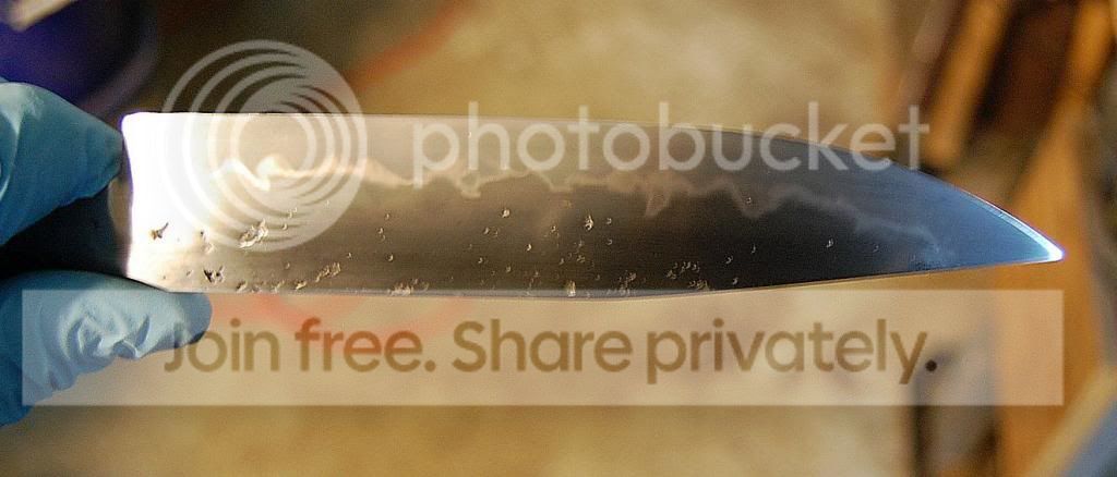

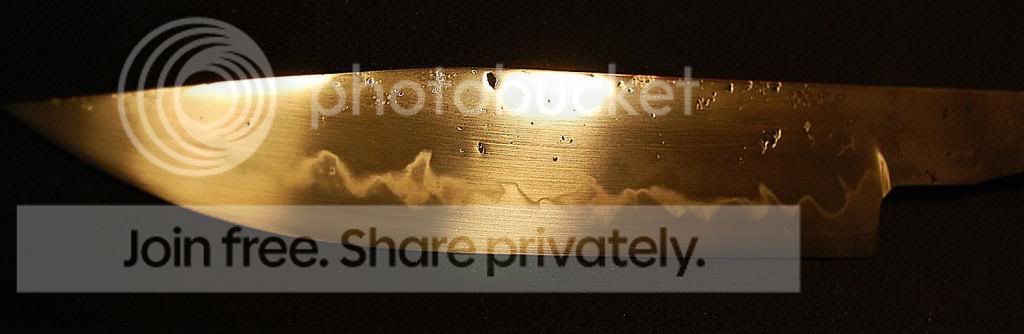

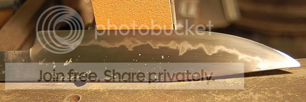

Well got the 1500 grit in today. So used that above the hamon line and used some I think its mothers below. Did a couple of lemon rubs inbetween doing the polishing. I did try a quick FC rub but it was just too strong. Wont be doing that again. It basically hid a bunch of detail so had to polish that all out and go back to lemon juice.
So after doing this I realized that my 1000grit initial sanding was probably too low a grit. Between the 1500grit abrasive and lemon juice it seemed to accentuate my sanding job in a bad way. The hamon really pops now though. I could see it clearly no matter what light. Before if it was in the wrong light or straight on it was visible but hard to see sometimes. Now you can pick out the details pretty much no matter what. Will be doing this next time thats for sure. More time I think but much better results. Ofcourse you gotta make sure you have a good HT to begin with.

Strig when I apply it I usually do a thin layer down each side of equal thickness down the same distance so they match pretty close. Then I do the little X's or random splots and try to get those somewhat equal. Never get it exact but I try and get it close. To be honest the big thing is getting the first major portion the same. The little X's or patterns or whatever the way I do it dont determine where the hamon line is, they just aid in getting the little ashi guys which in my experience are about as random as they come.
Now there are makers that layout very specific lines in the clay to get the little fingers to match up on both sides and have a more controlled randomness if you get my drift. Then you have guys like Nick who are masters at the HT and dont even use clay, there hamons are more random but also controlled by blade profile (and temp and all that good stuff) more then anything. I mean if you use salt pots and have exact temperature you can ride that line and get a wonderful looking auto hamon with more whispy patterns.
I personally go with a defined area or line per say that shows as much activity as I can get if that makes sense. Just what I can do with what I got and what I like.
