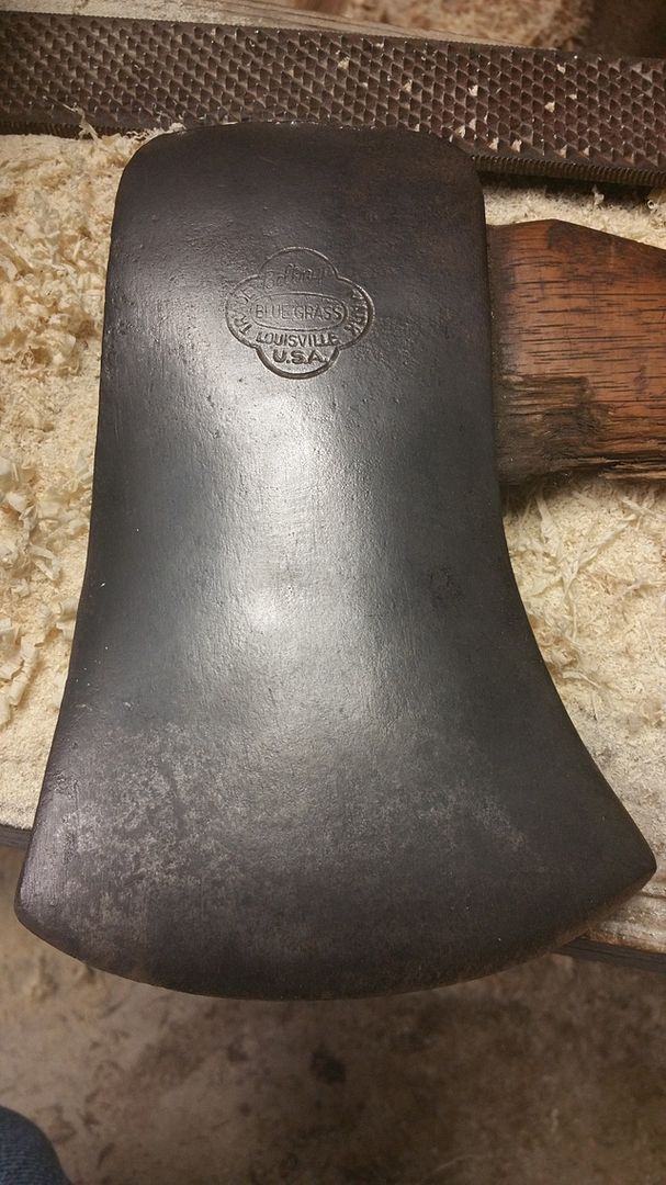

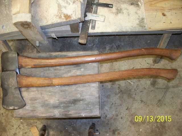

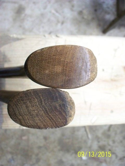

You may not have seen these pics of some older axes I have with horizontal grain. They have sure stood up to some abuse over the years.. Some of the failures people have witnessed may just be twist, and run out so bad it looks to be side ways grain. You never know with sawn billets. In a good quality riven helve, there is no run out(other than man made) regardless of grain orientation..

Fair enough. Twisted grain can be incredibly strong. And there are a lot of factors that affect haft strength. But one factor is grain orientation.

Beautiful axe head. Looks like that haft has stood up to some over-strikes, too.
If an axe is use properly, it well seldom fail. But we often abuse axes, usually unintentionally. Proper grain orientation (and other factors) give us some insurance.
