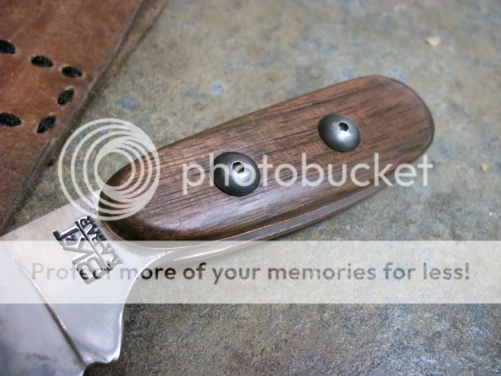

Another set of Osage Orange, got working too fast and screwed up the hexes on the opposite side, i guess I'll keep these ones.
Uploaded with ImageShack.us
I would have any knife I own wear your mess ups. Looking good!
I appreciate the complement. It wasn't a cosmetic flaw. Those hex nut have a special cut on them to hold the nut tight so they don't spin when cranking down the bolts. I oversized the the hexes and the nuts spin on two of the three holes when tightening. Just wasn't paying close enough attention.

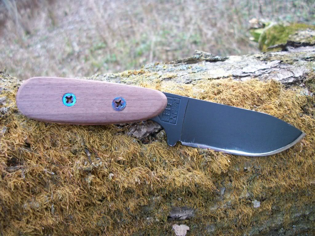

Here is my Groovy Stippled Grivory and then a shaved butt BK2

I do them a bit different from you, but not too much, and your tutorial is plenty good. I think if I do one, I'll do it strictly with hand tools, the poor man's way, excepting the sanding. Gonna use a cheap belt sander, since that shouldn't be too hard to come by for the folks without tools.
I was kinda thinking I'd want the scales to go to someone who doesn't have your obvious skills though, and actually needs some new scales to replace their Grivory. Whattaya think? If I send em to you, would you be up for making some for another BH member who needs new scales?
I don't generally do the wood carving of the holes either, not having wood carving tools. I usually just leave a large enough hole for them to sit in.
The other thing I do is use stain and a glove to help guide my shaping, so that I can get it to be as comfortable as possible for a hand. So mine tend to be a bit more comfortable for the dominant hand than the non dominant one.
