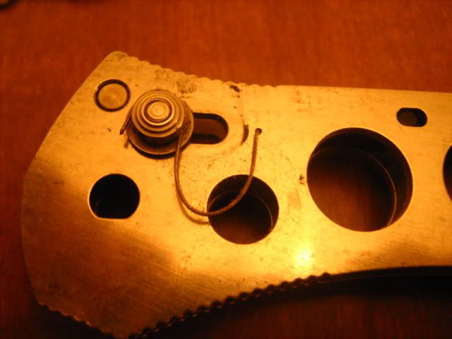

When the springs break ... where is it? Where they wrap around the bar, bend into the liner or both?
Here's an old picture I snapped of the broken spring in my 710. My guess is some gunk got in there and put stress on the spring until it broke. I noticed one day that it wasn't opening very smoothly and decided to open it up and take a look. It still locked open just fine though, so I wouldn't be too concerned about having only one spring.
Thanks for the picture!
Man, broke almost right it the middle.
I was thinking that a stress riser could develop at the sharp bends at the ends.
I guess the middle is actually where the most flexing is happening.
Wonder if they break in different spots or consistently in one spot.
Mine both broke at the very middle of the curve, both on the same spot.

I will say that I replaced the springs with ones I bent out of nickel-plated, steel guitar strings. I've sense cycled the lock open and close many, many more times than I did in the course of breaking both original springs. So all I can say is that my self-fashioned, guitar string springs are better than Benchmade's; I can't say why, but just by the fact that they've outlasted the Benchmades makes me think there's problems. Not only have they outlasted the ones I got from Benchmade by the same amount, but I've literally been trying to break them and haven't been successful.
I don't think it would be a problem if Benchmade didn't void your warranty for disassembly though. I didn't have the money to ship mine off just to get the spring replaced and opted to have a usable knife instead. So now my warranty is void. When you really think about the implications of that... Benchmade won't stand behind their knife now that I've disassembled it, and I had to disassemble it for springs that didn't last nearly as long as my self-fashioned guitar-string springs. I don't think that should happen on a knife that they suggest a $205 retail on.
Either they should change their warranty policy or make springs that won't fail. For anyone. Ever.

You know, seeing that picture of the broken spring one can see that if one pulls the lock rod furthest to the back/left one can see that the springs are going to bend by a lot. I have been told by Mechanical Engineers that the life of a spring depends on the deflection or strain. And that the relationship is not linear.
What I'm saying is imagine drilling an itty bitty hole further to the left to slot the Omega spring. That way the springs do not bend so much hence increased lifecycle. Of course if it done then the Omega Spring needs to be redesign it's shape slightly.
Another thing, could Benchmade used little helical springs like the ZT0500 on either side? Do you guys think it's possible? Not sure since it's got a tight space to fill. Would be nice if Benchmade could join this discussion :)

Regardless of the percentage of incident, what sticks out to me is that I rectified the problem and still haven't experienced any spring failure with self-fashioned springs made out of higher quality metal. I don't know what BM used, but I don't it was $1 per meter like the stuff I bought as that would probably get spendy in production. However, having not been able to make that stuff fail, and then considering all the people without failure on the BM metal used in the springs, I think it would be safe to say that there's some kind of QC issue where some knives are getting springs that aren't up to snuff.

Aside from the 710 which I absolutely adore, I'm not much of a Benchmade fan. The broken omega spring was more of a mild irritation to me and I didn't hold it against the knife or the company. I used that knife hard, and a tiny little piece of spring broke, not a big deal.
I still think the Axis lock is one of the better locks on the market if you have to have a locking folder (which I don't, I'm a slipjoint kind of guy these days), and I'd certainly consider buying another Axis locking folder if it caught my eye.
