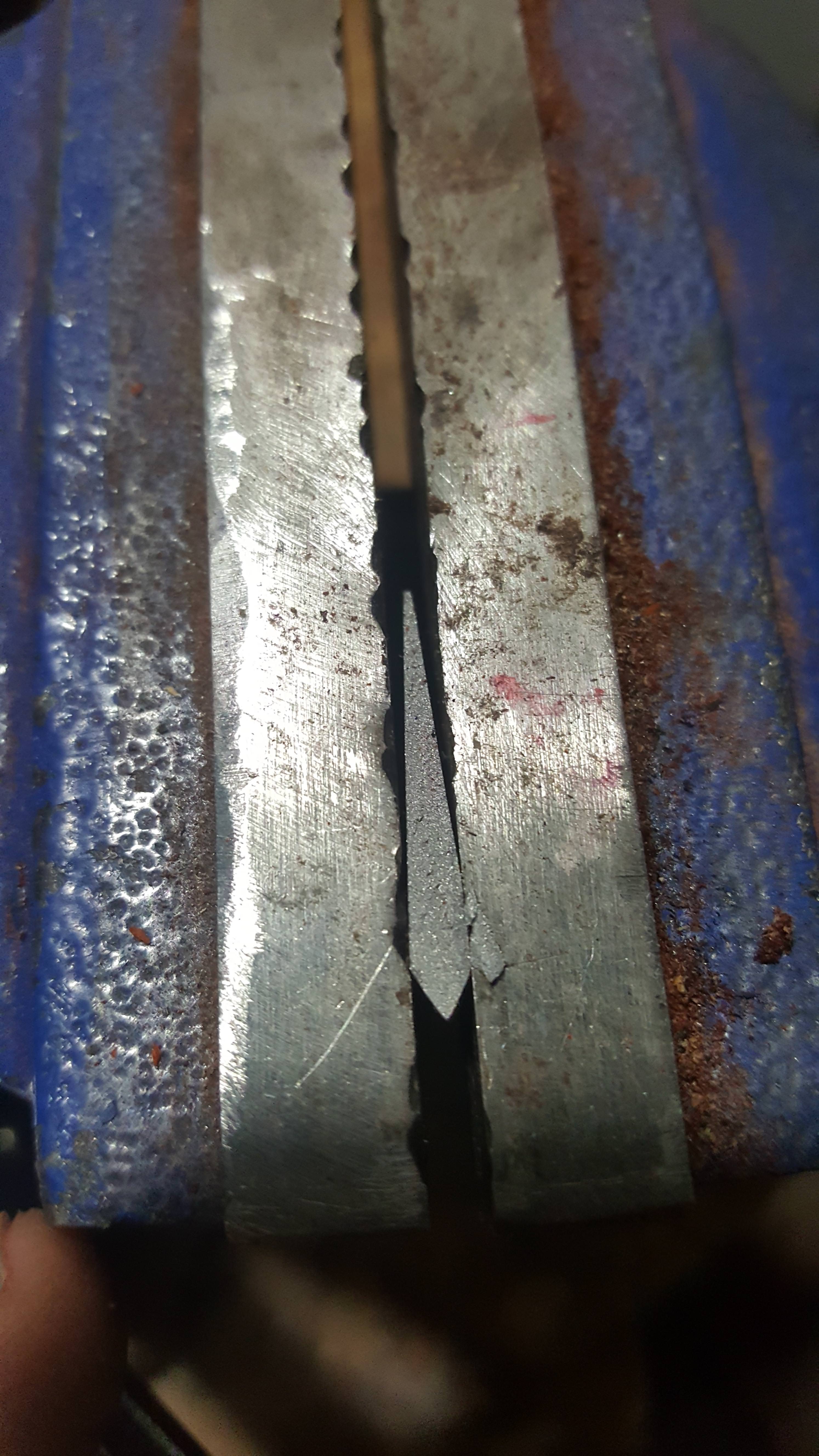

Well the fighter ive been working on kinda took a dump. So i broke it to check the grain. This is what it looked like:
Looks burnt? Also it only bent MAYBE 30 degrees before snapping.

That grain don t look good at all ............
Hmm alright thanks don. Thats after a few normalizing cycles as i stated before. Maybe holding it and quenching in a higher than optimal heat like you said is the culprit
Grain grows during normalization. The grains end up the same size, so grain refinement following normalization causes new grains to form within the even grain boundaries caused by the original normalization.
