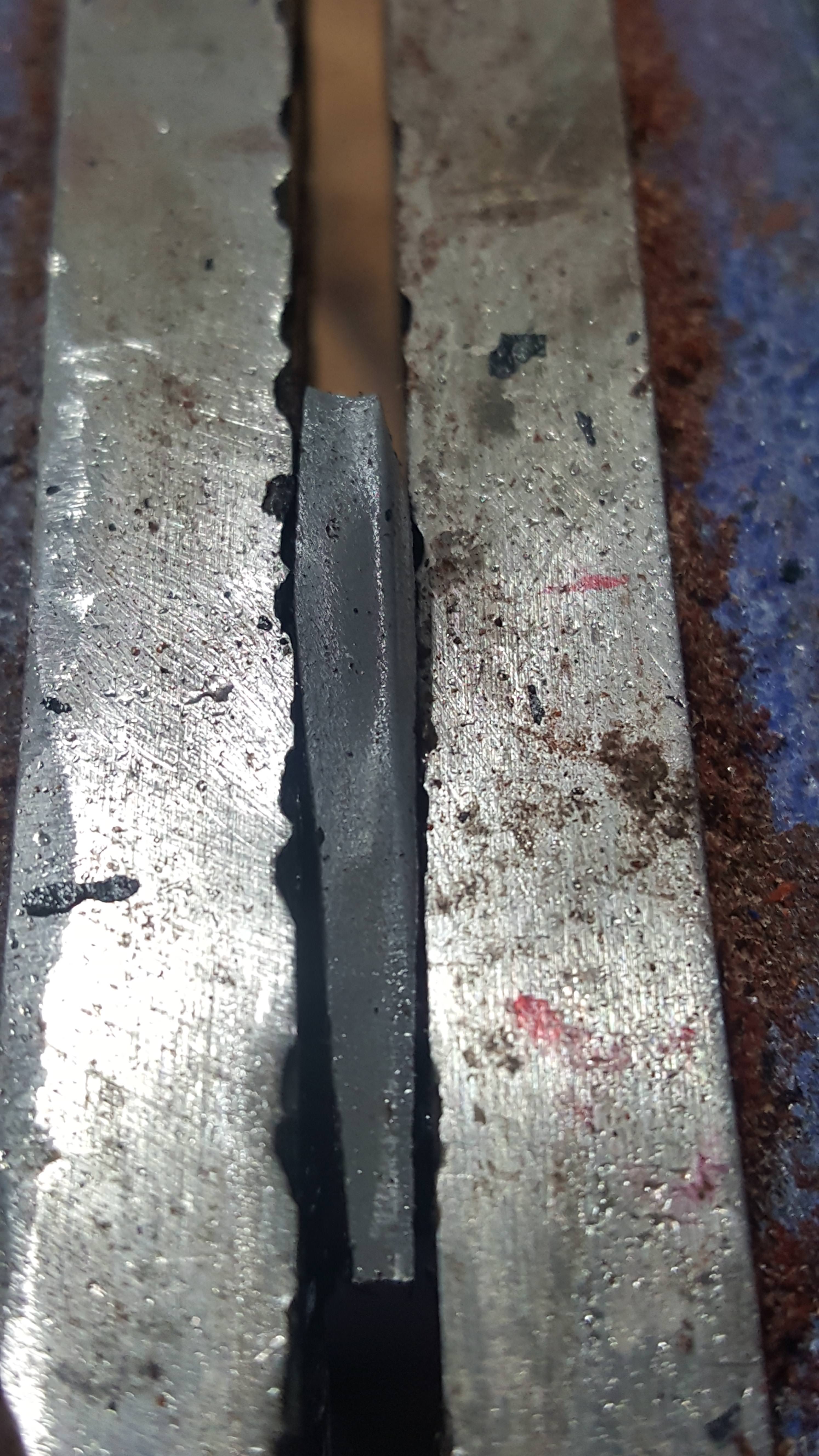

That makes alot of sense. Ive gotten really fine grain with this steel multiple times. I think im forging too hot. And trying to hold to long as both you and don have suggested. Guess more testing is in my future lol
If you are going to forge the blades it makes sense to follow that method with the coupons.
Alright well i forged out a blade yesterday, ill go ahead and ht it and just wont hold at temp then break it and see what it looks like. If it looks good i will know my problem is as don mentioned amd im over heating pre quench. If it doesn't look good then it must've gotten too hot during forging. Sound about right?

Much better! Took don amd javands advice and as soon as i got uniform heat above critical i quenched in the AAA bada bing bada boom
Honestly, unless you see sparklers coming off the steel when it's white hot, you can't really get it too hot when forging, as long as you do a full thermal cycle with reducing heats to reduce grain. I think way too much is made of this, consider that all (ok most) damascus (carbon) is welded at 2300 to well over 2400 degrees (any of you that don't have thermocouples in your welding forges are likely running above 2400 degrees, most wont realize, until you see how much darker a 2300 degree forge is once you add a TC), much hotter than this and you start burning steel.
Forging temps are usually MUCH lower than this, but even if you are forging at yellow heat, other than decarb (which you can grind away) or large grain (which you can thermal cycle away) you're not hurting it. However, you can control grain growth, and to some degree reduce grain size, from forging at lower temps, but there's a limit, and at a certain point, you're liable to introduce fractures/cracks if you forge too heavy at too low a temp.
Javand thaat makes alot of sense. Like most new guys i over think it. But grain seems to be back on track. Thanks don and everyone!
I allways like to look at a break when it’s fresh and clean. Take that same test blade and clean off the oil and wipe it down. Then snap it and take a picture of the grain befor anything touches the surface. Keep fingers and oil Exe off the fresh surface. Lots of times this stuff will cloud the results and make the grain look better then it actualy is
