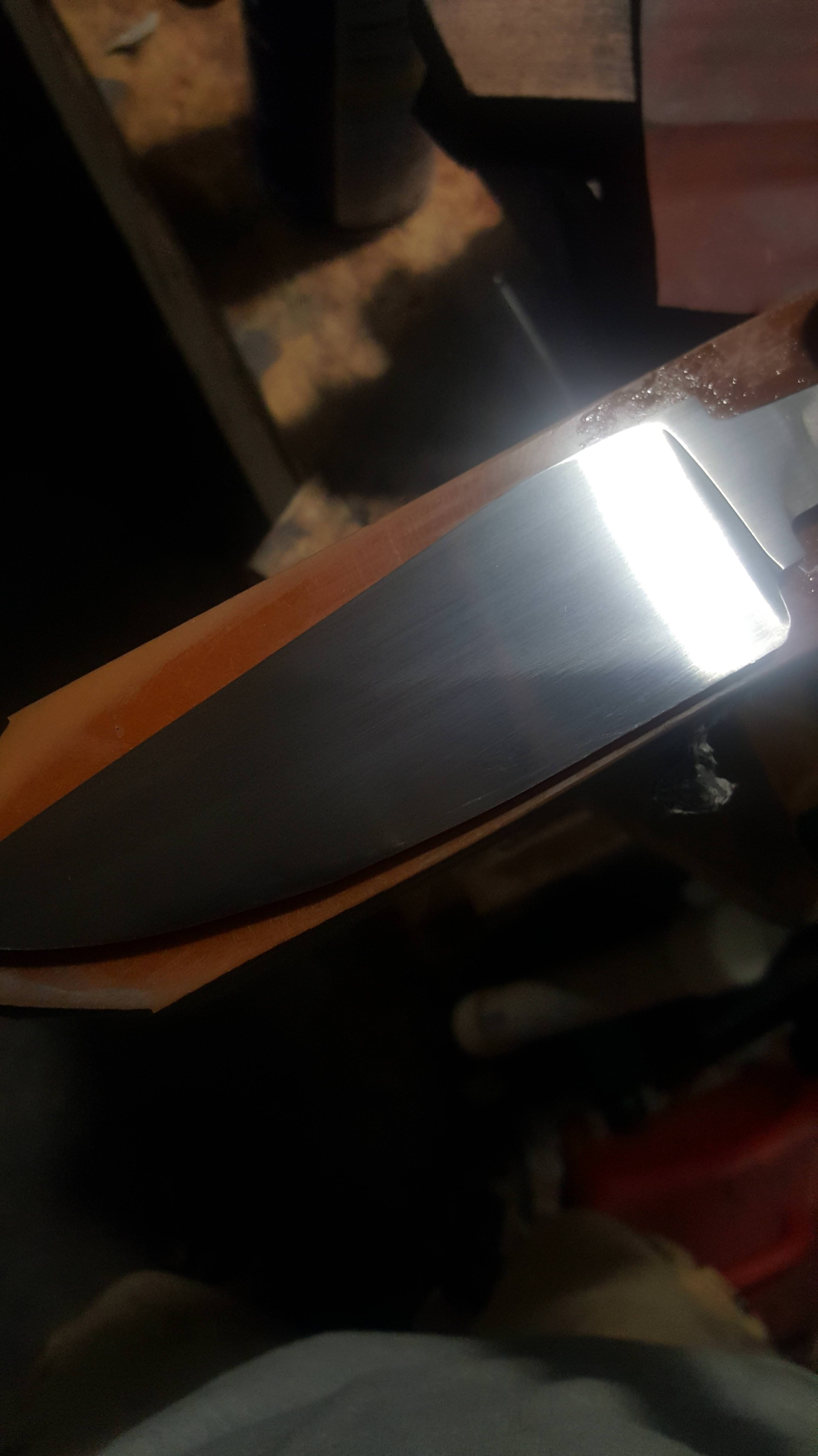

Alright ill have to try that. Just grind the decarb and what not? I took it straight from the quench and snapped it
No reason to grind decarb off after hardening for a test coupon, but it's informative to grind it clean before hardening. That'll give you an idea whether you're introducing any significant decarb in the process.
I'd let it rest a minute and make sure it's fully cool to ambient before snapping.
Alright so could i use 1095 or w2 with these methods if i get some P50? Just did this with 80crv2 so im kinda excited. Just a temper line but i want to expierence a real hamon
Yes p50 will work on w2 and lots of other steels. If you’re going to order it, Maxim oil has it and it’s not terribly expensive. Probably around $125-$150.
