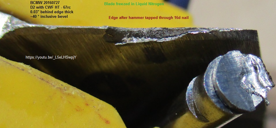

Conventional hardened D2 known to be brittle. At 67rc should be like glass. At below transition temperature, this blade should behave like a thin sugar glass.
CWF ht (hardened) D2 at 67rc LN2 freezed did well with hammer tapped through 16D nail.
[video]https://youtu.be/_L5eLHSwpjY[/video]
Close up on edge afterward
Thermal expansion sounds boring but you will probably hear more about it in CWF disclosure.

So the damage is isolated to impacted area without propagating further and shattered the whole frozen blade ... whoa :eek:
I'm wondering if Hitachi White said to be the purest carbon steel will be most suitable for CWF? Why do you choose D2 for the test?
CWF HT is applicable to most Fe+C matrix steels, except has low to zero benefit for low alloy steels with less than 0.2%C. So yes, Hitachi white#1-2 and heck their lower grade #3-5 as well, would get better result with CWF HT.
D2 because it is near worse-case scenario end of brittleness at room & below transition temperature. A sharpened iron bar (or bar made out of gummy bear or rubber) would be brittle when freezed with LN2. Thus far CWF weaved-matrix LN2 frozen blades performed extraordinary well (I haven't able to establish a unbroken baseline/control conventional ht blades yet).

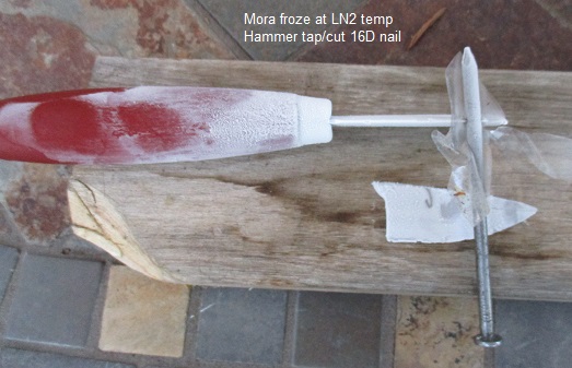

No, it has nothing to do with cryo. He froze the blade and then hammered it into a nail to see if it would propagate a fracture all the way through the blade and it did not. Good test. Problem is that there is no reference. If you take a standard D2 blade and freeze it will it do the same if shaped the same or will it fracture? who knows.
Cobalt - See red bold... Yeah, I broken plenty of test & some production blades at LN2 temperature. I couldn't find an instance of any samples or reference on the internet which can do this either, therefore Can't Establish Baseline/Ref/Control - unless calling broken pieces as reference.
edit: ok just went and killed my Mora knife froze at LN2 temp against 16D nail. Tap = 2 pieces.
edit2: just rockwell tested of mora blade, avg 3 reading = 59rc.
