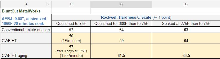

I had to read the procedure again. I don't think he's reheat treating, though he's done that for people. It sounds like he's doing a slower than normal cooling rate marquenching all the way to cryogenic temperatures, then a very low temper near 275 deg F. He's also relying on the auto tempering from slow cooling through the formation range of martensite. That notion does bring a question, as the auto tempering must be slight indeed to retain such high hardnesses.
I'll go back and try to figure it out. I didn't think that he actually went into the deep cryo range(-320)

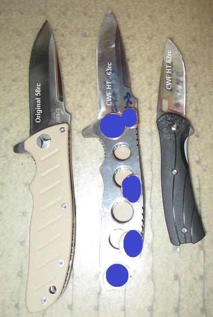

I cryo/LN2 dip (for a few minutes). LN2 is prefer over dry ice because of extra compression (thermal contraction).
64rc AEB-L has excellent wear resistant and impact toughness - really http://www.bluntcutmetalworks.com/i...tchen-util-thin-hollow-vs-turkey-thigh-bones/
edit to add: btw - if you guys interested in seeing side-to-side Enlan 8CrMoV vs Enlan 8CrMov CWF re-ht. And maybe cwf re-ht 62rc 420HC (I've only 1 Buck knife).... let me know, I might :) shoot a video.
Hi Luong,
I'm interested. Enlan was my introduction to some good tough design. The 8Cr wasn't really up there though, so BCMW Enlan will be interesting!
I didn't cared much about the look(masked out expensive washers), heheh... Maybe I will be more gentle with disassembly next time.
Both CWF HT blades easily out cut BM940 s30v. 58rc 8CrMoV dulls quickly - can't even compete with opinel carbone.

Marquench/Martempering is about equalize work piece right above Martensite Start(Ms). CWF HT quench cool to 450-465F then 1F/minute cooling toward room temp. I see very little overlapped between the 2, hence not much value to compare them. Done, right?
Are there conventional ht produces similar result to cwf ht?
Although there are a bunch of responses for aebl, amplitude changes but the curve is more/less the same. Maybe, it will become clearer once you got there & scratching your head.
As stated before - I am barely on this path and was hoping others join to explore & discover.

Last night, I thinned out the original Enlan and did head-to-head tests video. Shot a long video but only first 3-4 minutes were clear, rest is fog/fuzz-in :grumpy:. Time to get rid of this new camera.
Original 0.014"BET/15dps, CWF HT 0.011"BET/15dps.
15 minutes cutting costco food grade cardboard boxes - both still smoothly slice phonebook paper. Orig is noisy after 5 minutes and stay that way.
Quick resharpened & ~100 whittle cuts black bamboo (bamboo is much more consistent than cardboard, guessing - this bamboo skin has about 3% of silica).
Orig: reflect light. Under 22x - apex width about 3x wider than cwf ht
cwf ht: Under 22x - apex is barely visible.
Chop into buloke wood: orig has visible smushed-in (folded over roll).
Whittle aluminum rod: orig has visible roll. cwf ht has loupe roll (not visible w/o magnification).
Whittle 16d nail: orig has large roll. cwf ht has visible small ripples.
edit (how could I forgot): Press cut paper clip (hardened steel - I think) on wood backing
orig: edge smushed down with shape of the paper clip radius
cwf ht: edge rippled - half as deep as orig. Can't push any harder than leaned my weigh on palm on blade spine.
* neither cut through the clip. cwf ht made deeper cut.
