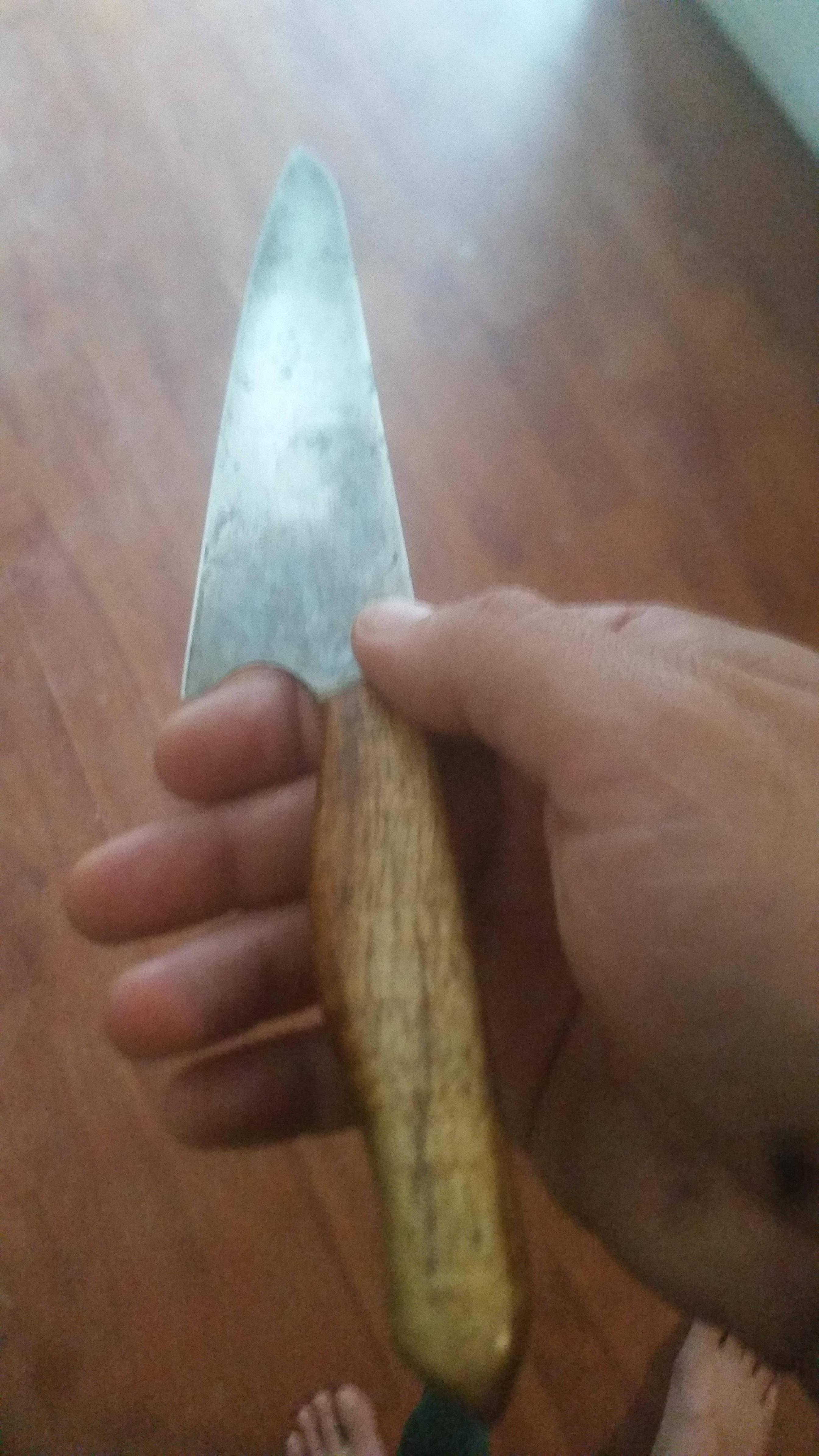

Agree. Hardened steel edge tool + cold + impact could = breakage.
I mentioned a few times above about steel transition temperature - i.e. rapid loss of toughness. Here are 2 videos testing cwf ht at temperature a few degrees colder than Canadian winter
[video=youtube_share;5-mVEp7BiLo]http://youtu.be/5-mVEp7BiLo[/video]
[video=youtube_share;_L5eLHSwpjY]http://youtu.be/_L5eLHSwpjY[/video]
I appreciate your warm offer in real-life testing cwf ht large/chopper blade in cold temperature. All along, I am hopping somebody else actually replicate cwf ht, so that multitudes of tests be done in wide environments. If/when in need of testing in cold temperature and thing is still in relevant context, I will give you a ping.
Thanks bodig fir the excellent link
The reason I ask is that I have had knives perform well at room temperature but fail catastrophically in sub zero temperatures
This is especially true when the knives are brought from a warm place (inside hot tent) to outside (-20to-39oC)
I have even seen a wetterling axe shatter !
