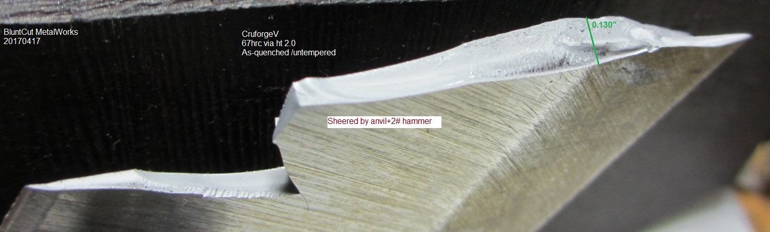

I sandwiched a test cruforgeV blade between anvil and 12 lbs hammer with one end of the blade dangling out. A hard sheer strike with a 2 lbs hammer - oh hey, this break look quite interesting ... at the same time - nonlinear break - which supports (1 sample statistic) with my assertion about CruV potential (hahaha better lucky than good)

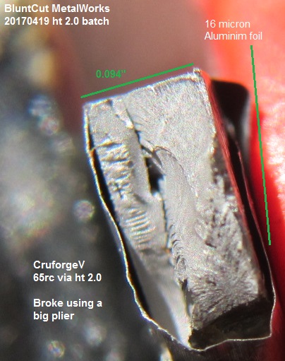

Snapped a small coupon attached to cruV 65rc test blade. I couldn't break it with a small plier and barely did with a big 10" (oal) plier. It bent and straightened then finally broke. Quite a surprise - how a 65rc has this much plasticity - so I kept grind and re-check hardness - 65rc validated 5+ times.

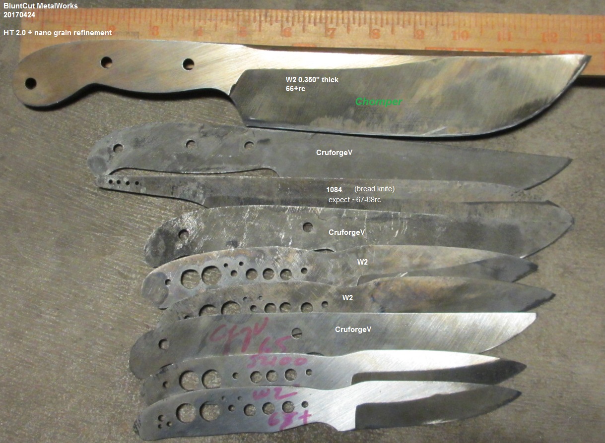

This afternoon, I cut & profiled 8 CfV blanks. Resuming/re-activing my nano-grain (suspended ~ 2yrs ago due to nano-cracks). Ht 2.0 fixed weak links in the nano-grain ht. This is way more fun than finishing s90v, niolox, 10v, etc knives ;)

edit to add comparison of broken surfaces:
Brittle - virtually no plasticity.

HT 2.0 with nano-grain refinement was long and slow process through the weekend. Oh why not have some fun doing long preparation process for nano-grain... So, I mod a W2 0.370" thick chopper blank into a chomper (hence a slightly narrow tang).

edit 1: 1084 67rc 7.5" bread knife

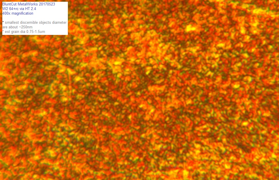

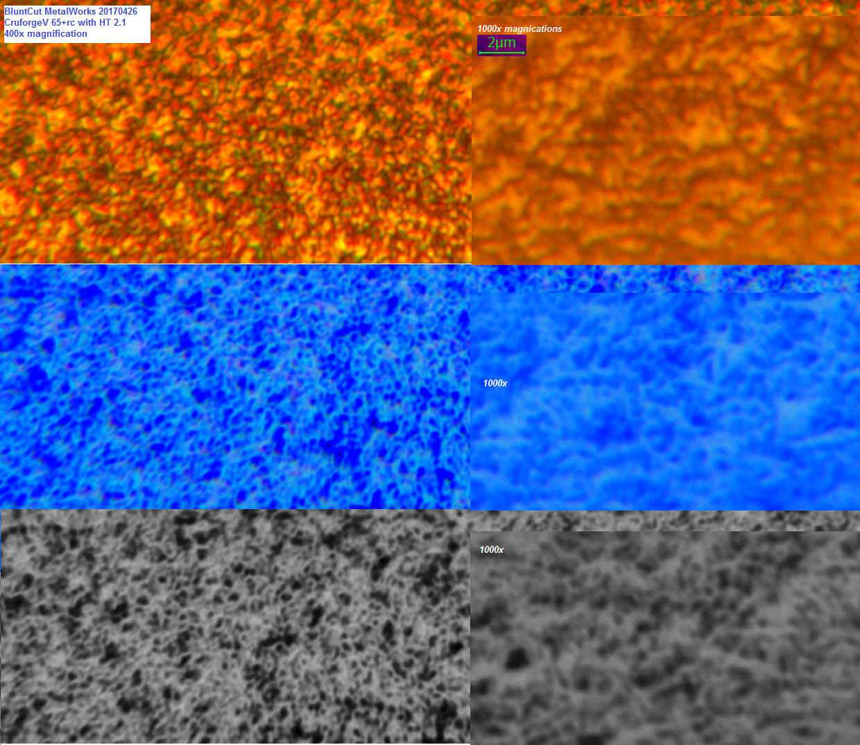

Eyeball guesstimated grain diameter between 0.7um and 1.5um (ASTM size between 16 and 18). For context/comparison - standard/industry ht cfv or Cr% steels grain dia 8um-10um-coarser (best-avg-poor).
Edit to add what nano grain martensite matrix looks like (EBSD image):

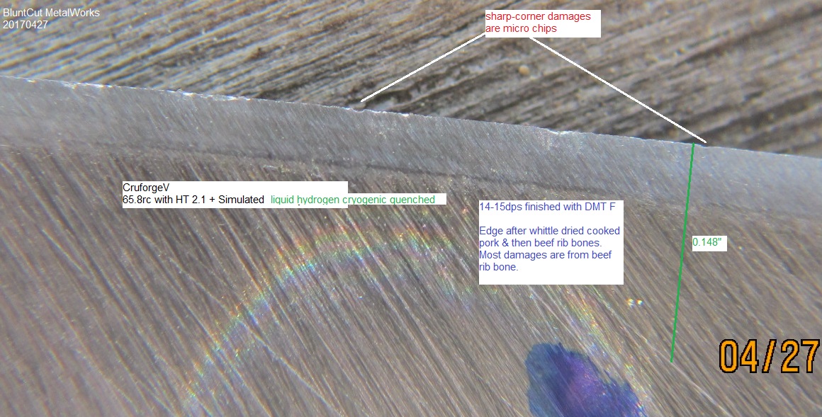

Edit 20170427.10: HRC(avg 3 reads) before and after SimLH2 - CfV 65.4 vs 65.9. Insufficient data -- due to +- 0.5rc hrc error margin, more larger sample data is needed. Grind went faster but again could be reduced(@30%) belt speed allows 50grit belt to dig deeper. Soon, I will test edge stability by whittle African Blackwood and dried cooked rib bones (pig & cow).
*11: 14-15dps DMT F passed whittle bamboo, AB, dried cooked pork rib bone. Micro-chips and ripples whittled dried cooked beef rib bone.
Resharpened to 15dps finished with 2K waterstone. Hard chopped cumaru wood and thick aluminum tube - edge under 22x mag is mostly rolled + rippled and didn't any chips.

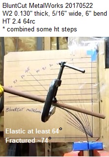

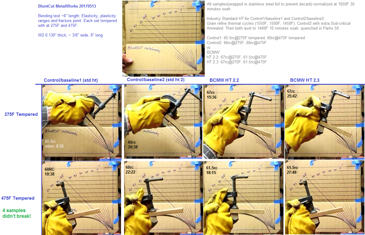

Bending Test: BCMW HT vs BF/Std HT
W2 0.130" thick, ~ 3/8" wide, 8" long
Bending test ~6" length: Elasticity, plasticity ranges and fracture point. Each set tempered with at 275F and 475F.
All samples(wrapped in stainless steel foil to prevent decarb) normalized at 1650F 30 minutes soak.
Industry Standard HT for Control1 and Control2:
Grain refine thermal cycles (1550F, 1500F, 1450F). Control2 with extra Sub-critical Annealed. Then both aust to 1460F 10 minutes soak, quenched in Parks 50.
Control1: 65.5rc@275F tempered, 60rc@475F tempered
Control2: 66rc@275F, 60rc@475F
vs
BCMW
HT 2.2: 67rc@275F, 61.5rc@475F
HT 2.3: 67rc@275F, 61.5rc@475F
Since the video is 29 minute long, so here is a summary (snapshots at particular time in video)
Edit to add ~max bending angle (using protractor) before fracture/break for 275F tempered samples:
Control1 - 42°, Control2 - 51°, HT 2.2 - 70°, HT 2.3 - 69°
From the image above - HT 2.x improved elasticity range over controls by more than 30% ((69-51)/51). From the video above - HT 2.x samples fractured more explosively than controls. When a load of stored/potential energy suddenly release, a higher load = higher explosiveness.
Implications/Applications? For edge-_tools/knives - HT 2.x brings x% higher edge stability+strength+toughness. For industrial (such as structural, spring) - possibly using x% less steel per specs. x% = tbd or to-be-calculate.

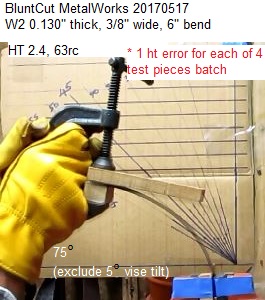

Another ht improvement idea popped in my head, sort of CWF' (prime), hence ht 2.4. I squeezed time to ht 2.4 4 w2 test bar identical to above. In a hurry, I messed up one (and possibly compromised part of another step). Anyway, goal is to find out HRC point enable to hit 90° bend. Results are far below my expectation/projection:
CWF' step didn't negatively affected results (if it has, certain characteristics of failure would show up) and IDK whether it has any benefit. Hopefully time permits for another test pursue at 90° bend (60° flex) at 62.5+rc.
** Correction Angle Bias for previous 2 posts **
My setup has ~5° vise tilt bias toward pulling force, so stated angles should be 5° lower

Taken BCMW HT 2.4 W2 at 64+rc, where ferrite+ra % is below 3%. Elastic(3) and Proportional(2) Limits are fairly simple to detect. Plasticity range is very narrow (between ref 3 and 4) - which look as if 50/50 from ref 2 to 4. Proportional means elongation+rotation is much stronger than displacement - dislocation move back/forth. However low ferrite% severely limit crystal slippage (forced by stretch+compress of dislocations). If this is actually the case - True Elastic Limit has much wider range. When operating/using below True Elastic Limit, there is no (statistically speaking) matrix fatigue. Consider this as no-mechanical movement system. Between TEL/1 to PEL/2 maps to life span of tools/blades based on cycles of crystal mechanical movements (slip back/forth). Just an obvious - we want TEL as large as possible - incredible long service life span. Longevity wise - Yep, it is more useful in a car leaf spring (thinner+shorter) than edge tools.

Tested 63rc, 63rc and 67rc bars - Elastic angle about 65° and fractured between 70-75°. At 0.130" thick, lowering hrc doesn't helped (blade/bar wise) until ferrite% beyond certain threshold. For W2 (and similar steels) I think, this ferrite% threshold is between 61-62rc. Thinner cross section (edge bevel) requires less ferrite% for supporting rotation displacement (micro-ripple & nano-roll).
