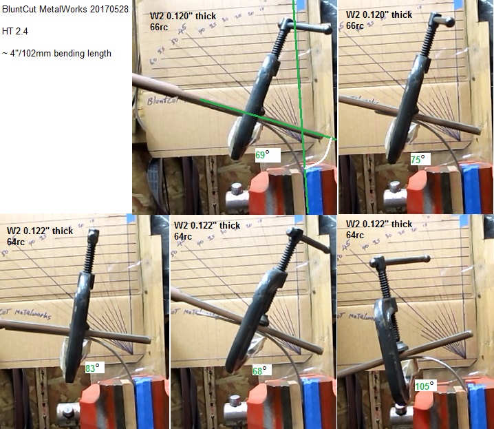

I took my time prepared test bars and leisurely shot a long video (22+ minutes *as a warning :p*)

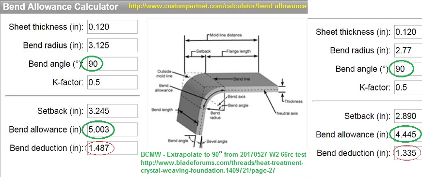

Bending test ~4" length (corrected - video stated 3.125" length but from freezed frames, bending length is close to 4")
W2 0.120" thick, ~ 5/16" wide. HT 2.4 - 66rc and 64trc bars.
Deduction/extrapolation of bending length to achieve 90 degrees bend angle - for W2 0.120" thick, 66rc above.
* keep in mind - this calculation under the assumption of fairly ductile steel, whereas this W2 bending is mostly elastic and very narrow plastic/ductile.
Radii below are for 69(left) and 75(right) degrees angle

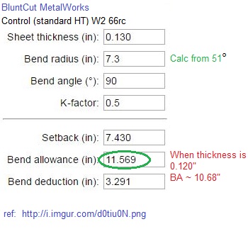

Compare against a control/baseline W2 at 66rc. So if control thickness is 0.120", minimum bending length to achieve 90° bending angle is ~10.68" long.
* for 0.25" thick: BA90° (R:6.4") = 10.25", BA90°(R:5.6") = 9"
General calculation

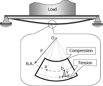

I found a cool drawing on grain roles in compressive side (inside arc) of bending. Easy to envision grains on the outside arc to be - elongate and bend along the arc line.
https://www.researchgate.net/profil...n-and-compression-layers-of-the-bend-zone.ppm
Figure-2-Grain-measurements-in-the-tension-and-compression-layers-of-the-bend-zone.ppm

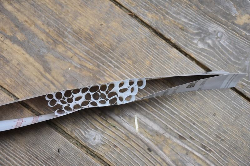

The diagram of grain elongation doesn’t seem quite right to me. My thought is that the grains would be stretched parallel to the blade on the inside and outside of the bend— and that stretching would make the steel more vulnerable to permanent bending or breaking on a second bend.
I tried to show that with a simple experiment:
A little crude, but here are the round(ish) grains before bending.
Not a perfect illustration, but after the bending, grains on both the inside and outside of the bend are elongated parallel to the blade.
Thanks! Great catch Twindog! I misread to graph (the darn outside circle threw me off). Neutral line is along those grain stay spherical/circular shape, thus grains on the outside part are stretch. Which agreed with general bending for hardened steel where K-factor is between 0.5 and 0.4 (t/T, depend on hardness - K is lower for higher hardness, I conservatively used 0.5). K-factor for your experiment look like closer to 1.0 (mostly stretch, almost no compress).
btw - (not really applicable but if) Diamond K-factor would be close to zero.
http://www.mathalino.com/sites/default/files/images/flexure-of-a-beam.jpg

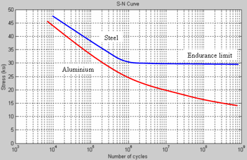

We are surrounded by limits - resisting is futile... Umm can we re-evaluate the one below? (please feel free to correct any of my newb in fatigue&yield fields)
https://en.wikipedia.org/wiki/Fatigue_limit
Typical values of the Endurance Limit (Se) for steels are 1/2 the ultimate tensile strength, to a maximum of 290 MPa (42 ksi)
Aah no wonder high-cycle spring (such as vehicle leaf spring) is thick & heavy ;)
5160 at 50rc has tensile strength around 1450 MPa but Se at 290MPa? Of course it supports higher load but will shorten life.

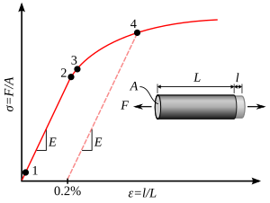

It seems correlated to - True Elastic Limit (TEL)
https://en.wikipedia.org/wiki/Yield_(engineering)
Stress–strain curve showing typical nonferrous alloys.

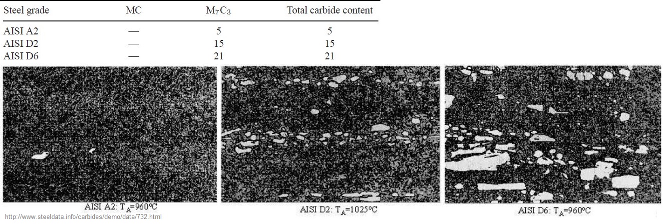

Take a martensite matrix with ~100% complete transformation (no RA and very little % of ferrite) at 66rc.
Se = when load cycles less than TEL.
2,3,4 are not far beyond TEL, since dislocations movement would lead to fast fatigue eventually fracture.
Why is TEL range so small/narrow for this matrix? Well high % of HRC reading came from as-quenched standing stressed/dislocation, so add a load on top would rapidly exceed crystal lattice yield point (slip). A metallurgy fact, right? Not really, this is just a poor initial condition. OK, tempered this matrix down a couple RC - well, it is just a less severe dislocations in neutral state (not flex) but quickly push/lean on each others with flex, so it will only extent TEL to Se max as HRC lower toward 49-50RC.
Existing metallurgical empirical data (various industries and academic) clearly confirmed the extreme brittleness of 66rc matrix. Elastic Limit (in term of bending angle for 4", 0.12" thick) would be less than 35 degrees, while TEL angle would (guess) be less than 5-6 degrees. Aha, that is why you don't see springs at 60+rc.

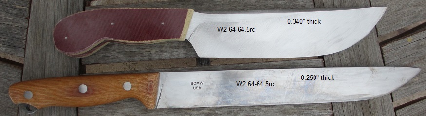

Chopper with ht 2.4 in actions...
It's hard to show how edge of a 64-64.5rc W2 chopper perform in a chop-about. A 58-62rc would do the job too, except this 64rc W2 afterward edge remain more keen/sharp than one at lower hrc. Per high tensile strength, it should able to take on m4/3v/a2/5160/... blades with std ht at any hardness.
This edge geometry is on the verge of binding, so going thinner would be counter-productive. This chopper blade supports major bending (if one is strong enough to bend it).
W2 1/4" thick, 10" blade, 16" OAL
64-64.5rc edge via HT 2.4, spine is torched back to lower HRC.
15-16dps with 18dps microbevel
Thickness: bevel shoulder 0.023", 1/8" up 0.034", 1/4 up 0.067"
Chops: dried eucalytus, green oak & sycamore.

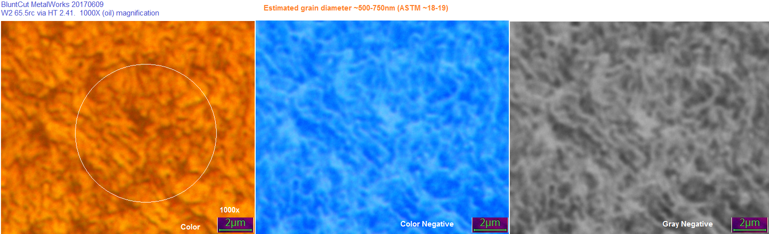

When grain diameter is below 500nm - optical microscope will no longer able to discern grain boundary. SEM/BSED probably won't able to resolve grain dia less than 100nm. For 750nm dia grain, I will try prevent substantial loss of hardness - hope to stay ~64rc. Tempering could also result in rapid loss of hardness - it's the case when dislocation is excessive.
Result of 8 test sticks and 4 blades W2 steel 1/8" thick. Hardness between 65-65.5rc, much better than pessimistic projection of 64rc, which mean possibly there is room for one more level of grain refinement.
Grain diameter is getting very close to optical microscope resolution (~250nm - wave length spectrum of visible light)

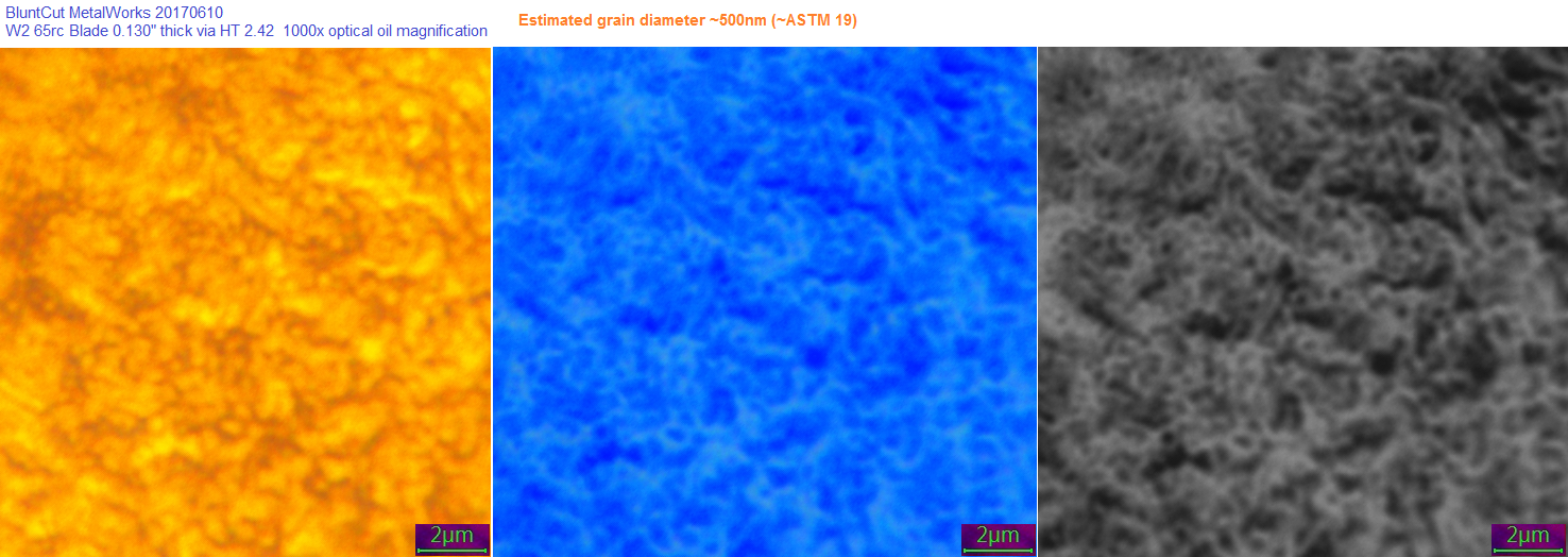

Got ht 2.42 done on a few W2 blades ~4.25" blade length, 65rc. 14dps/16dps-micro edge passed whittled ebony, African blackwood(AB), frozen cooked beef rib bone. Chopped AB: mostly fine, 1 visible riple, 2 micro rolled (visible with 10x loupe). I will try tune ht params for grain diameter toward 200nm.
Micrograph of W2 blade
