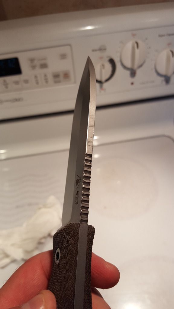

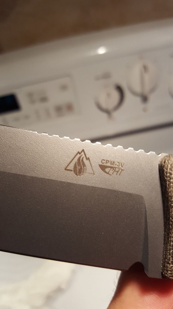

Alright, I didn't have time last night so i did the job this morning just now, here are some quick cell-phone pics:
My GSO-5.1 and a couple of hardware-store hones:
Here is the smaller one - coarse/fine 1"x3" SiC or AlOx hone that cost ~$1 at the local hardware store
This is what the untouched side of the jimping looks like
And after rubbing the coarse-side of that little stone back and forth and rounding over the other side, <60 seconds later
One could use this same stone or another to round the edges between the jimping if desired (a round ceramic rod would work perfect for that), but this gives you an idea of what can be done quickly/easily/cheaply to improve your comfort. Just rub it to the desired grit/polish and go :)
