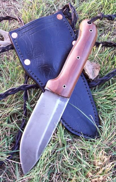

Dan, a couple months ago I modded a Becker Campanion, no longer in production. This knife has a straight spine, large handle. It's full tang made from thick stock.
I like this knife because of the strong belly to the blade, but it also has a straight spine which makes batoning easier, IMO.
I think a knife with the same general dimensions, but in somewhat thinner stock would be a great bushcraft knife. The steel should be a quality high carbon, pretty tough but easily sharpened.
Here is a pic of the one I modded -
I changed the handle because it was way too big and bulky. I definitely like the blade shape because I think it allows the user to use the point for drilling, and it puts the point in a straight line with the handle so more force can be brought to bear.
One thing I would change about the general design is, the end of the tang is not free standing so that it can be hammered on if the user wishes. Scales that come right to the end of the tang could be damaged or dislodged, so a 1/4" or so of bare tang would be a good thing.
