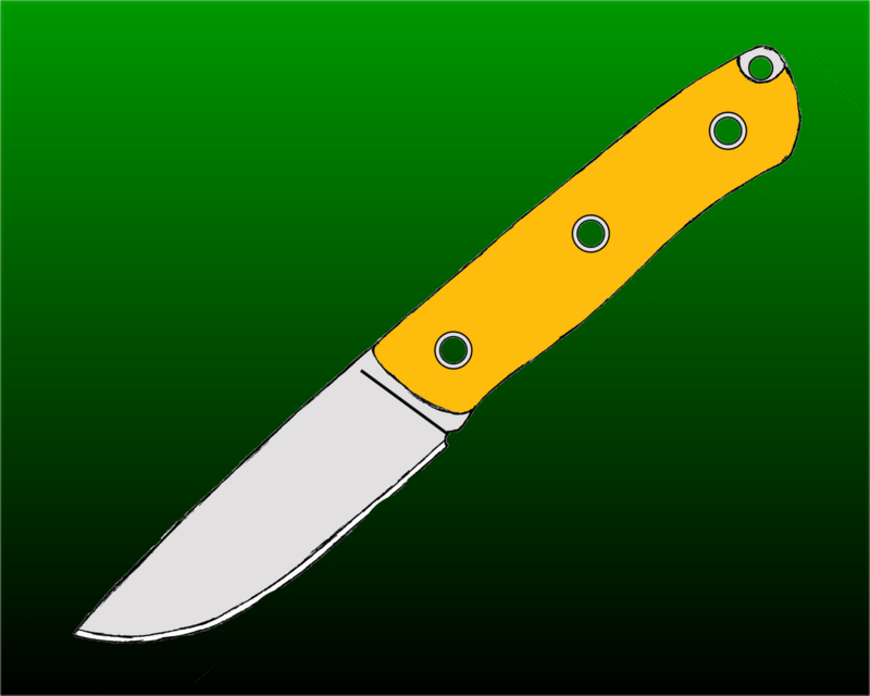

Ok...here's #4
a mod on #2

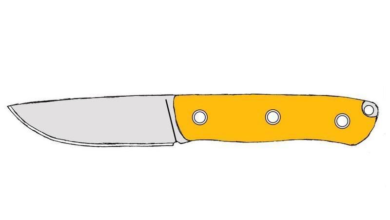

I want to keep this as simple as possible - and easy to put together, etc. Even considering bolt-on handles (removable). What do you guys think?
#4
  • No holes in the blade (the more I think about this...the less I like it. especially a hole close to the handle. That's the favorite place for knives to break: handle/blade junction.
  • scandi grind only, 1/8" thick steel. 5/32" will be tougher, but also heavier, more expensive and possible too thick for a scandi grind - which seems to be the way to go.
  • I thickened up the handle at the front (made it taller top to bottom)
I'm not against the ideas posted here...just trying to pick out the ones that will most easily/quickly fit into the toolery I have now...and my work flow, etc. Also, ones that will not only keep costs under control...but maybe even make it less expensive to make. For example, the scandi grind with a forged-finish is an easy knife to make and greatly lowers costs. I wouldn't want this on all knives...but on a bushcraft...it would be nice.
I'm thinking I'd like to keep this maybe even under $100....! :eek:
So, let's move toward that goal....simple, easy to use, easy to sharpen, good steel, user-grade finish, tough materials, etc.
removable handles might also save me some time/money....glue-up takes time.
As it stands now...the scandi-ground nessmuks take less than 2 hours of labor (removing tempering time and down-time, and doing them in batches).
Ideally...I'd like to get this down to a one-hour knife....would be pretty cool, eh? ;)
Just thinkin' out loud. Let's hear more ideas.

Dan d'ya think you could keep the bottom of the blade level with the handle but maybe shape the handle to form a guard maybe a little like this pic below....
5/32" Convex sounds good !!!

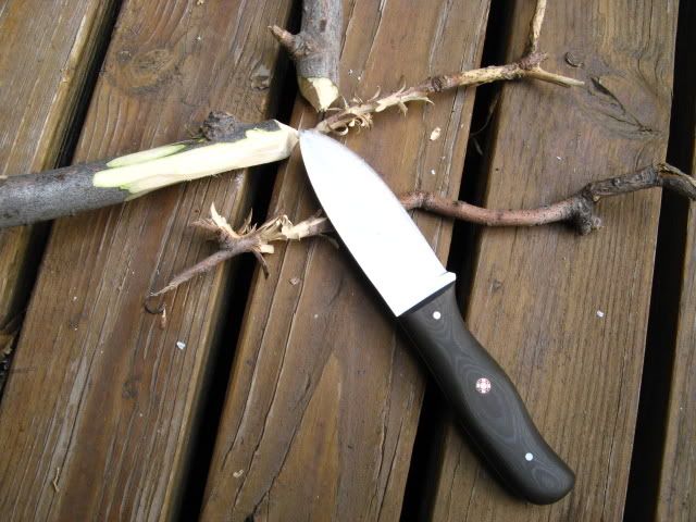

I think that the #3 knife is the best design for the bushcraft knife so far. The reason I think that is because I own puukko knives that are similar to that design and those knives are great at working with wood, which is the primary job that a bushcraft knife will have to do(making traps, shelter,fuzz sticks etc...). I own knives that are similar to design 1 and 2 and they just are not as good as the more basic puukko design for making traps and such. As far as food prep gos I think that your nessmuk knife really fits that bill rather nicely. Please don't put any holes in the blade. The handle should bulge slightly at the center and taper at both ends. An oval cross section of the handle would make that knife just about perfect.:)

If it were me I would add some belly to the handle and give it a nice contoured ergonomic grip. I would also shorten the extended tang and make it less 'pointy', or get rid of it all together.
You should try to avoid a non-contoured handle to edge configuration like depicted in picture #3, you should try bringing the edge down a little and allowing a ‘ditch’ for the index finger to lay, this will help prevent hand slippage without getting in the way as a finger guard will.
