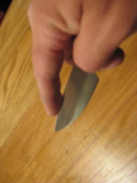

Same basic shape as a Mora but with a full exposed tang.
4 inch blade of 01 carbon steel 1/8 to 3/16 thick
Canvas Micarta handle attached with three flared tubes
Scandi grind for sure easy field sharpening.
Kydex sheath with firesteel and a cut down DMT Diamond stone riveted to the back.The sheath should have flared tubing all around so you can tie it to any pack or anywhere.
I'd like to add my two cents.
I would like to see forward serrations on the spine right were the index finger rests using this grip.
And I think that the micarta needs to have some sort of texture to it, a rope pattern or some sort of scale pattern would work.
4 inch blade. Green micarta or curly maple handles. Full tang, with a bit sticking out at the end. Flat, scandi, or convex ground. Drop point or clip point. Steel? Carbon steel, D2, or H1. No metal guard, but deep cutouts in the handle for the first two fingers. Jimping on the spine. A choil might be nice, but is not necessary. Leather sheath with a pouch for a firesteel.

I would like to see an index finger groove added to your drawing, Dan. Sheath designed for horizontal carry on the belt...maybe lashing notches for pack carry?
I think this is almost perfect. I would like to see the integrated choil in the handle though. I like the idea of a horizontal/vertical sheath in the style I received for my Nessie. Good job Dan! It definitely is looking to be a strong design.:thumbup:
I would like to see the mora profile with a full tang, red micarta handle, and a 1/8" thick carbon steelblade. This would be a very simple classic design. You could call it "The America Mora".
Dan, why are there holes in the blade?
Other than that, I maybe would make the handle straighter with the blade, and more symetrical from front to back, same width and thickness.
Looking good!
Andy

The first drawings nailed the food prep part of the equation. Extend the micarta over the pommel and it would be a great kitchen/steak knife. For the woodcraft part I would prefer a palm swell, top and bottom, in the vertical dimension and some more thickness in the scales, 1/16" additional each side.
The second one is getting close but needs a bit of shape to the handle to stop the hand sliding into the blade !
I also think that the blade should be 5/32" rather than 1/8" so it can take a little more abuse !!!
Looking good !!!!!
I like where that is going... both pitdog and EIDO have good suggestions. Contour the handle like they suggested, add a bit more thickness and belly to the blade, and by god you are almost there! Convex grind, please!

Dan,
I like your last drawing, but the handle just needs alittle more contour. I like the mora handle in my post.
Dan,
I do like it better without the holes in the blade. I am not sure what the purpose of them would be, but no holes defnitely looks better if nothing else. Also, less food to get in blade holes and have to clean up. All in all, less maintenance without the holes.
I am going to chime in and say to please stay with 1/8, not 5/32. Edge geometry (and sharpness) is very important, arguably the most important factor, in being able to cut finely. If someone is going to break it at 1/8, they will likely break it at 5/32 as well. Please keep her at 1/8.
