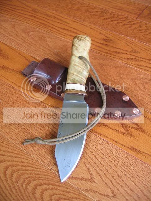

Looks good, heres one iv made very similar shape. hope it gives you some ideas.
[/IMG]
Bondy, very nice looking knife! What thickness stock is that? The handle material is excellent, may I ask what it is?

Thanks michealmcgo its 01 3mm thick ,scales are olive wood. hey magnussen what is the advantage of the lanyard in the middle of the handle.
