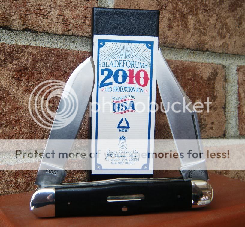

The 2010 Traditional Forum Moose knife seems to fit your requirements pretty well!
Here's a shot of mine - Love it!
