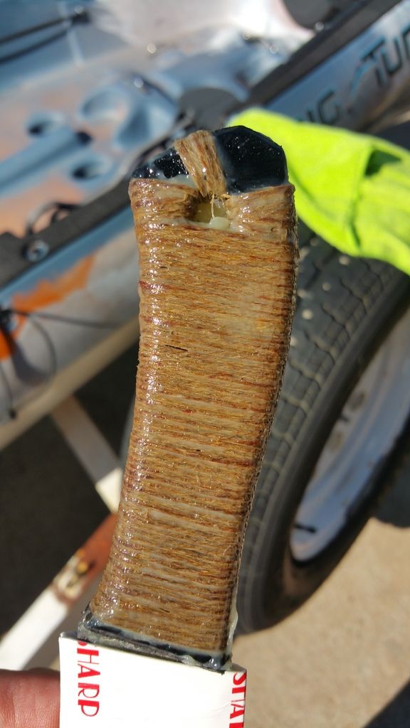

I coat the handles by hand with the epoxy and work it into all of the nooks and cranies. Completely saturate everything. Once it is all dry, light sand to make it uniform, then dipped and brushed with penetrating sealant for a second layer of protection.

The howards wouldn't do much of anything. If you wanted to reseal it at some point, you could use boil linseed oil or polyurethane. Just my thoughts

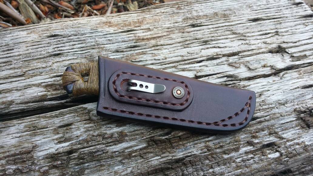

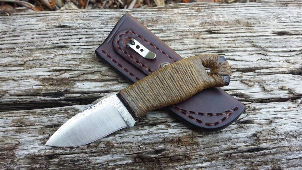

Found something that protects and seals up the hemp nicely. It's the Obenauf’s Heavy Duty LP (Leather Preservative) that I use on my Jou'fuu sheath.
I slather it on heavily with fingers, let sit for around 5 minutes, remove excess with microfiber towel carefully while turning the towel to a dry spot and soaking up the excess. Let it dry and it's good to go.
--after applying/before removing excess
--after removal and allowed to dry
