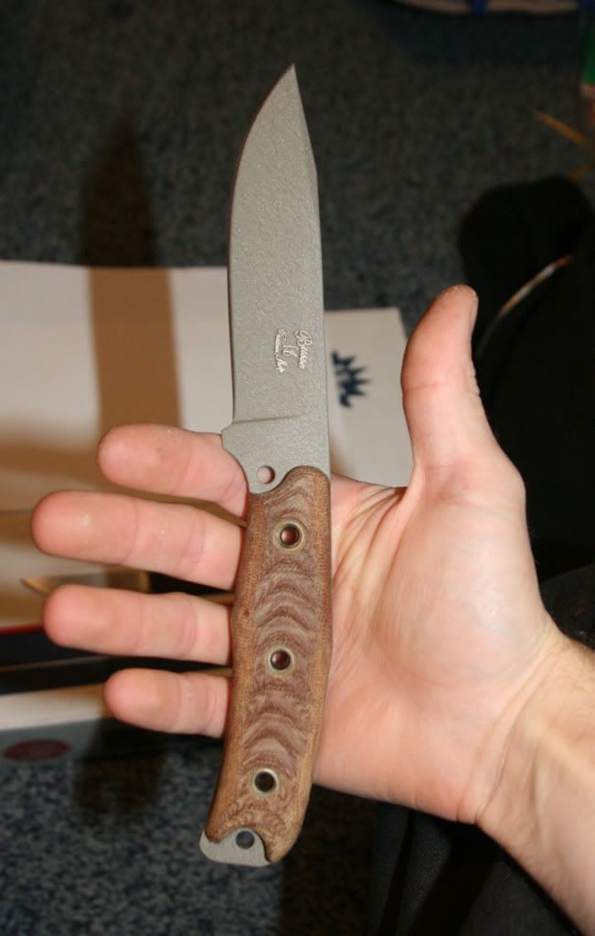

I got the sar5 I sent in for customization. I got that fairly fast, about 4 months. still haven't been charged for it either :confused: I don't understand exactly what was going on with that one, but I sent an email to garth asking if I owed anything on it, and never got a reply. maybe shop credits:confused:
anyways, I love it. Could use a larger thicker gaurd and some cnc'd canvas micarta, but it's great as it is. thin edge, sharp tip, controllable handle, more then long enough to take out any vital organ (or onion :p ). the epoxy grip actually gets grippier when wet.
http://i274.photobucket.com/albums/jj265/lastvisiblecanary/IMG_5368-1.jpg
which became this, because I should have gotten the handle cut down and the scales remade, but I wanted to minimize the amount of work the custom shop had to do (for turnaround time). mostly I just wanted the blade done up like this, and couldn't do it myself.

This is the first time I've seen this one LVC...
Pretty cool mod on the SAR 5. :cool:
