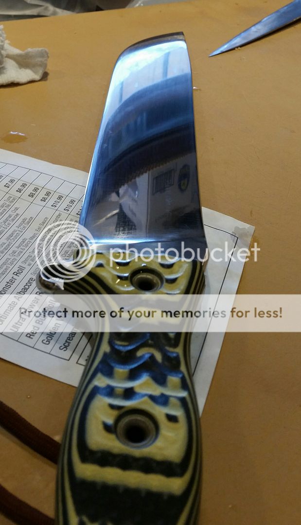

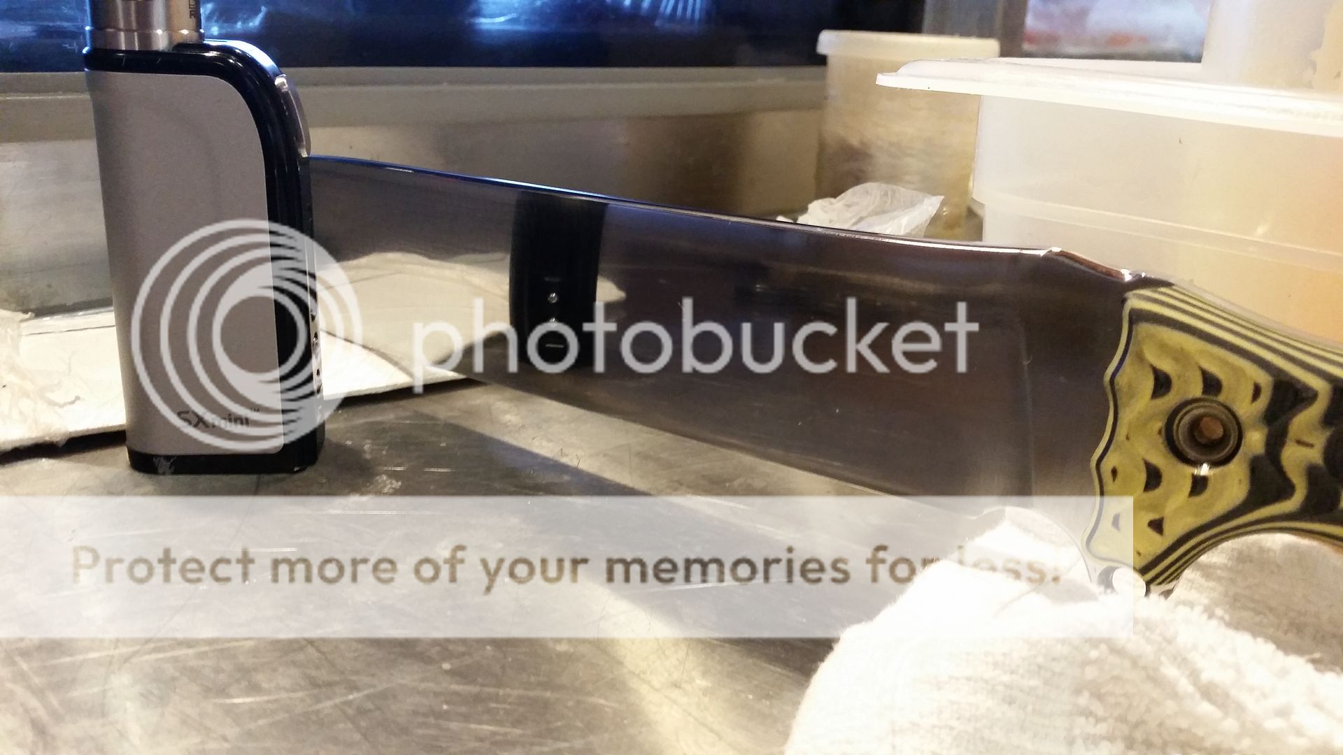

High polished busse, lets see yours
Spent my 2 hour break at work polishing ONE side of the nmfbm.
And is no even close to being done, but damn it's shiny!
Also the BUSSE logo got removed in the process, oops.
I probably should get high grit sandpaper too, perhaps 3000.
Seems the satin finish on this busse is around 400 grit, as 400 makes about the same scratch marks.
Get some metal polish.... It will speed it up
Do I apply the metal polish to the sand paper? Never used metal polish before.
I want the whole blade as shiny as it's spine.
I use old socks... One to apply the paste to the blade and another to clean the blade after it hazes over. Think about waxing a car, except you are polishing the blade. Polish on, polish off.... When the spot where your fingers are becomes black switch spots. Keep a clean area with polish on it.... I use mother's mag and aluminum polish. It's not hard, you've got it...
