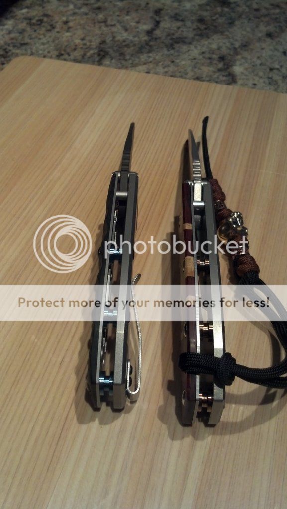

Hinderer standoffs on a zt 560 will it work
Did you use the Hinderer screws to make those standoffs work? If so did you just order them from Hinderer, and how much did they run?
I didn't make them work, a good friend of mine did (Same one who made the awesome Wood Scale ZT0551 for me) , but its using the stock Screws so no it doesn't need Hinderer Screws.
On the one hand, that's really awesome you had that done, it's sweet!
On the other, it sucks that I can't order a couple of parts and have the same thing :p
Don't mean to bring this from the grave, but any word on the titanium standoffs? I would love to complement it with my blue titanium LBS on the ZT560 CBCF
The XM-18 standoffs and hardware will work...HOWEVER....as was mentioned...you do have to file the handle nuts to fit as they are too long for the 560...and the standoffs for the XM-18 is .195 in width...the standoffs for the 560 is .205...so thats a full .010 thicker...So they may not be the perfect solution to a Ti standoff...BUT...I am considering making a run of the 560 Standoffs in Titanium so you all can customize your 560's with titanium standoffs using the original 560 hardware! What do you think?

as a side note I did buy some .205 titanium standoffs from knife kits and they were too small
